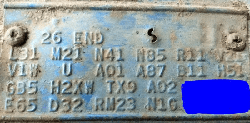

Speaking of desirable color, what are the rest of the details on this car? Options?
Do you have the fender tag?
I do have the tag- though to profess total ignorance, I noticed that when I'd seen tag images, they typically had an entity redacted (lower RH corner?).
Is that it case? If so- is this a sort if identity fraud protection effort? ...Hoping I got this right(!!):
PS- When I initially checked out the tag info, it looked to me like the car was assigned front disc brakes, but it has drums up there.

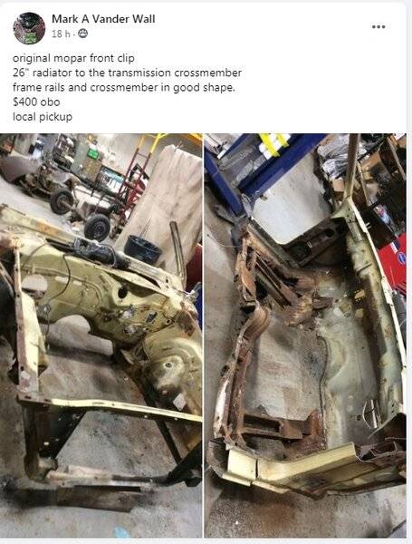

Facebook group is closed so you would need to became a member to check the link
That’s perfect Nacho!

That appears to be exactly what's necessary to repair the front end of this Roadrunner- Thank you so much. !!.
Quick question: Noting that I am quite green to the notion of dealing in major surgeries such as this. Is the removal/replacement of the front end as depicted in this item something that should strictly be left to the pros &/or experts in these matters, or is this something that a diligent, but wholly unitiated individual could accomplish? -especially w/respect to the pillars & door alignment/rocker tie-in. -Thanks again!
Replacing the entire front assembly-rails, rad support, trans cross member is a nice way to do it. Keeps everything aligned as a unit. If you are searching for a donor, any 71-72 Coronet or Satellite 4 door can donate the parts you need.
