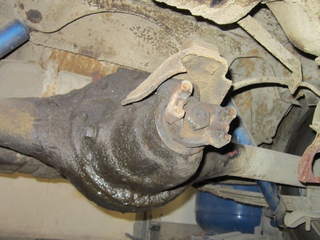

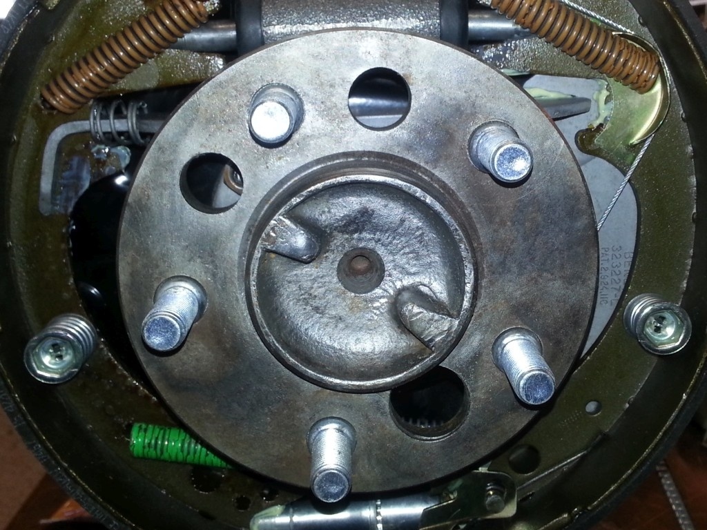

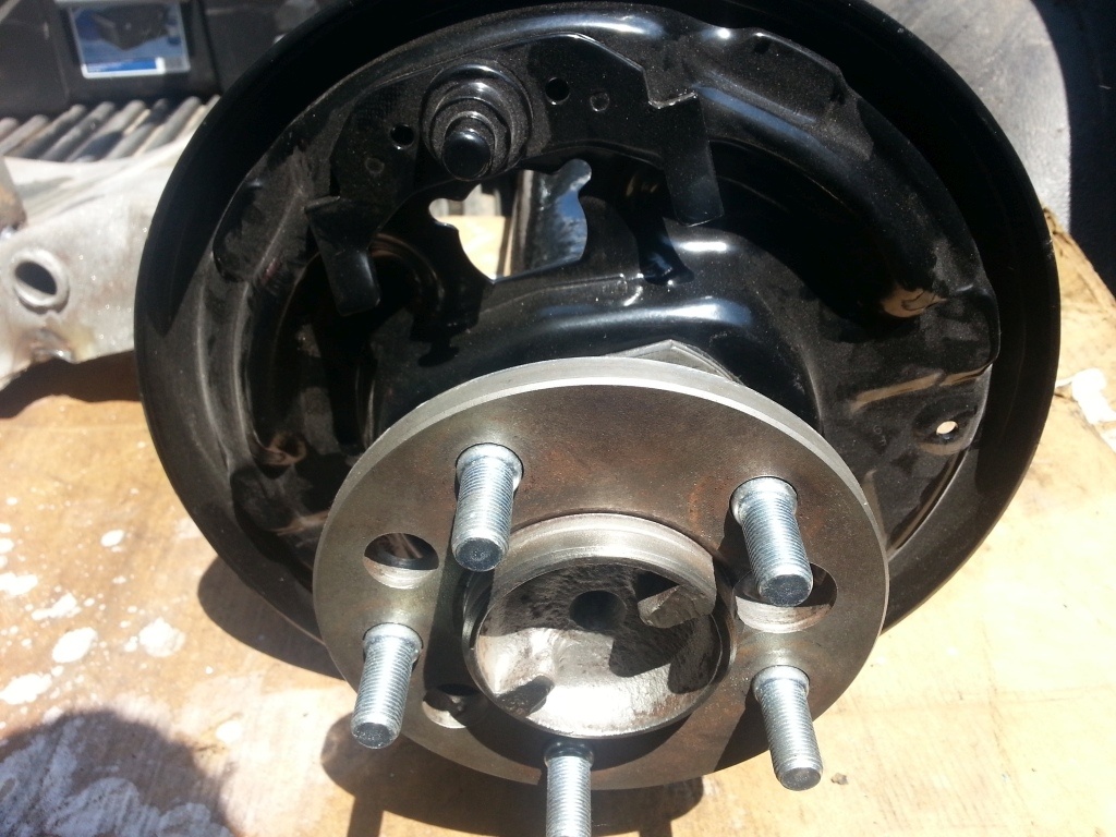

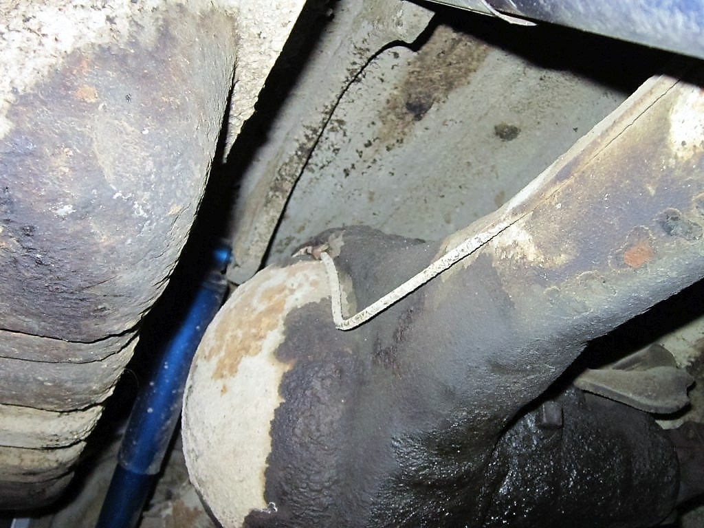

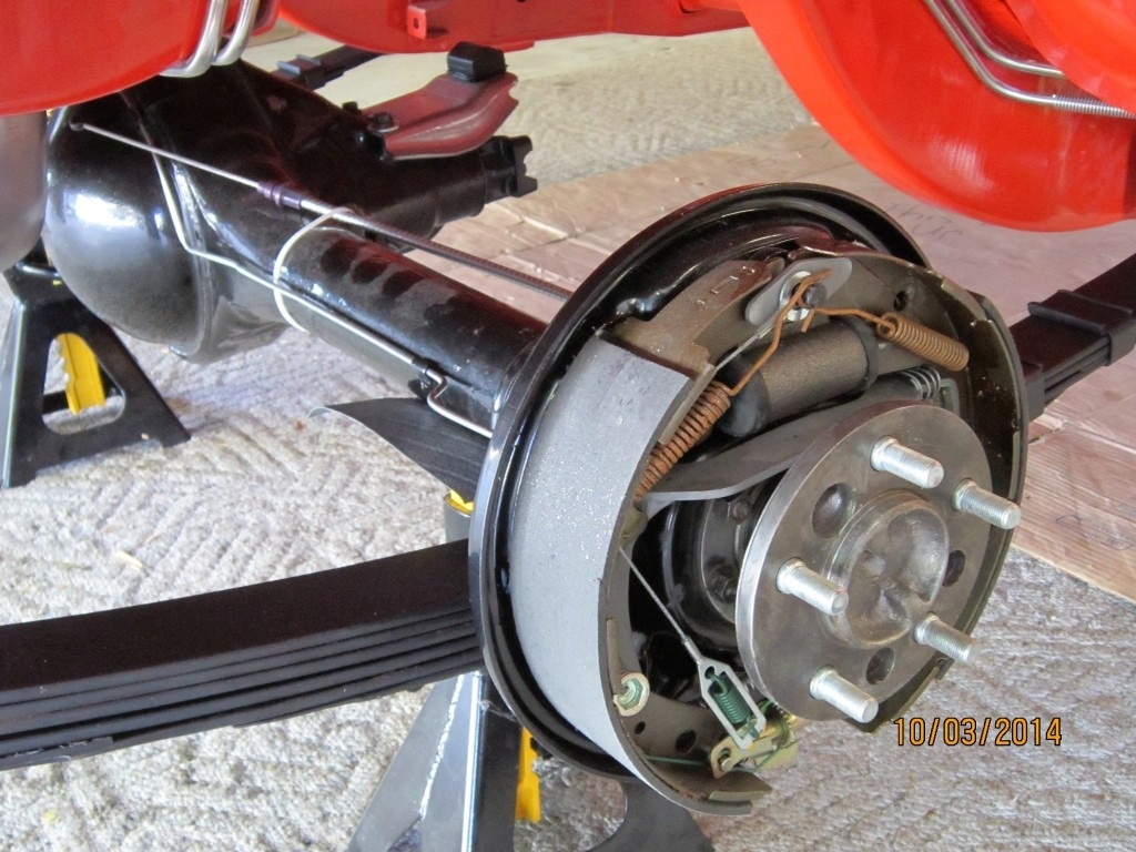

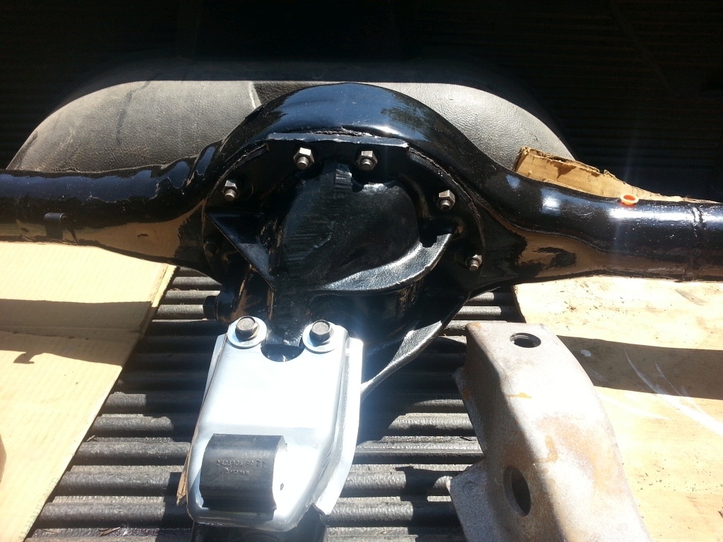

Rear end, before and after. Friend of mine has been a Chrysler mechanic at the same dealership for 35 years. He built his own NHRA drag racer and it's a screamer. With his credentials, he offered to rebuilt my rear end and tranny for me. I had the rear end housing powder coated, some might not like it. I did the brakes and brake lines myself

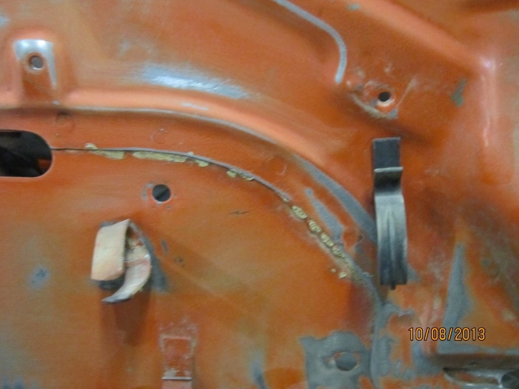

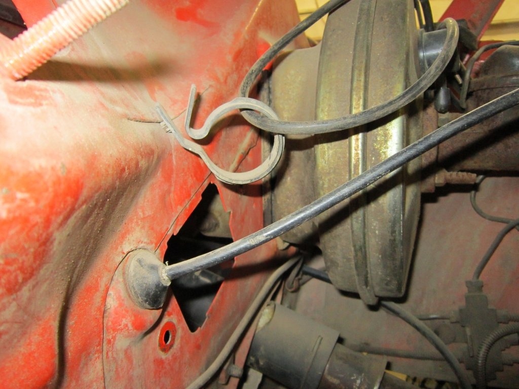

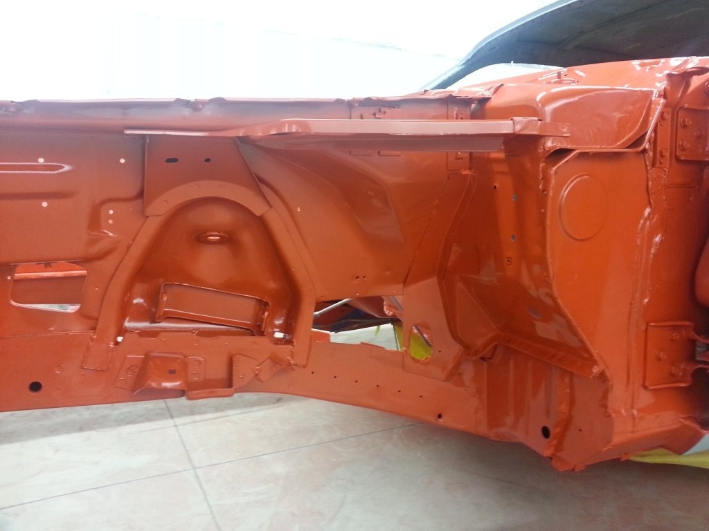

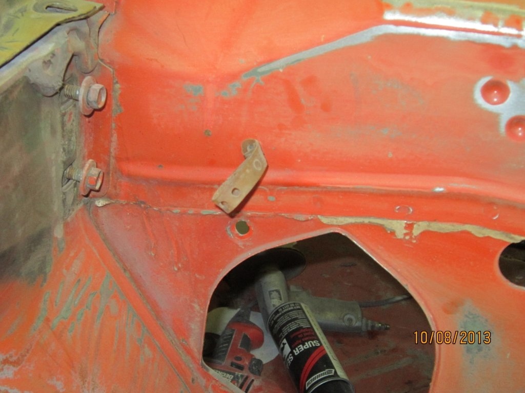

Rear quarters, behind the rear wheels. On the fenders behind the front wheels AKA "Dog legs". After you get the front fenders off, look at the corners of where the fenders attach to the fire walls as seen in my pictures. Anything else, you should see in plain sight. If you're doing a full tear down, either media blast or have the car chemically stripped to see any and all bad areas
It's really solid but it will be completely stripped and put on the rotisserie. I've got a guy that will handle the blasting but am going to check on getting it dipped if it's an option around here.

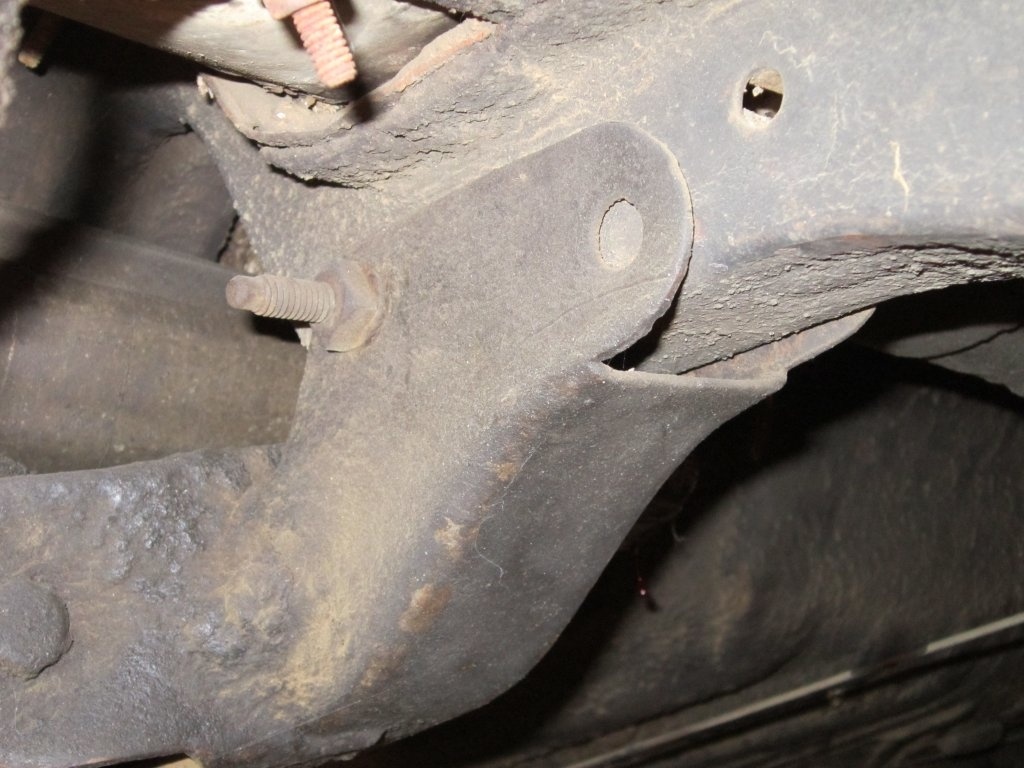

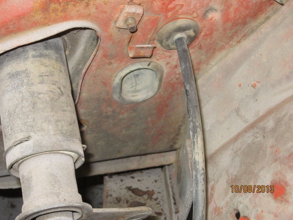

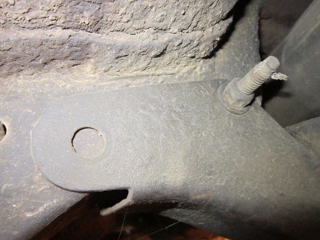

When I started tearing my car apart, I've found that this car has had somewhat of a hard life until my dad bought it. Again,there was a 2 year gap from when my dad tracked down the 2nd owner, from the original. In that 2 year frame, the engine was changed and underneath the car had some weird damage. I cannot explain how. Anyway, this is how I found the tranny crossmember. You can see that it was held in place by only 2 bolts! Also, you can see where the crossmember didn't meet 2 holes in the body. I corrected this with the correct crossmember and new hardware.

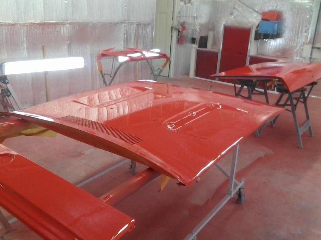

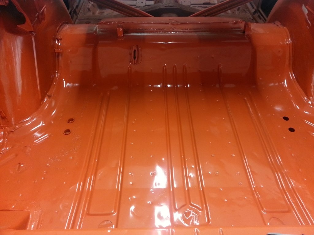

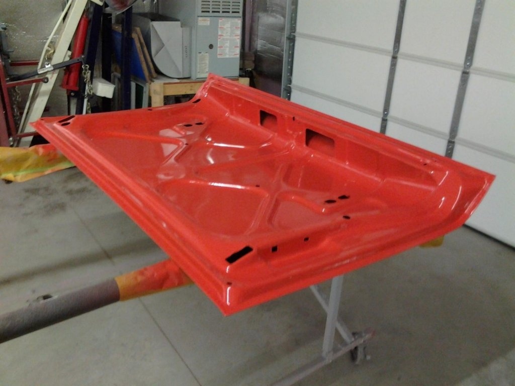

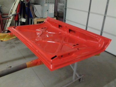

Trunk lid and trunk compartment painted painted. Trunk looks red in this picture but it sure is Tor-Red

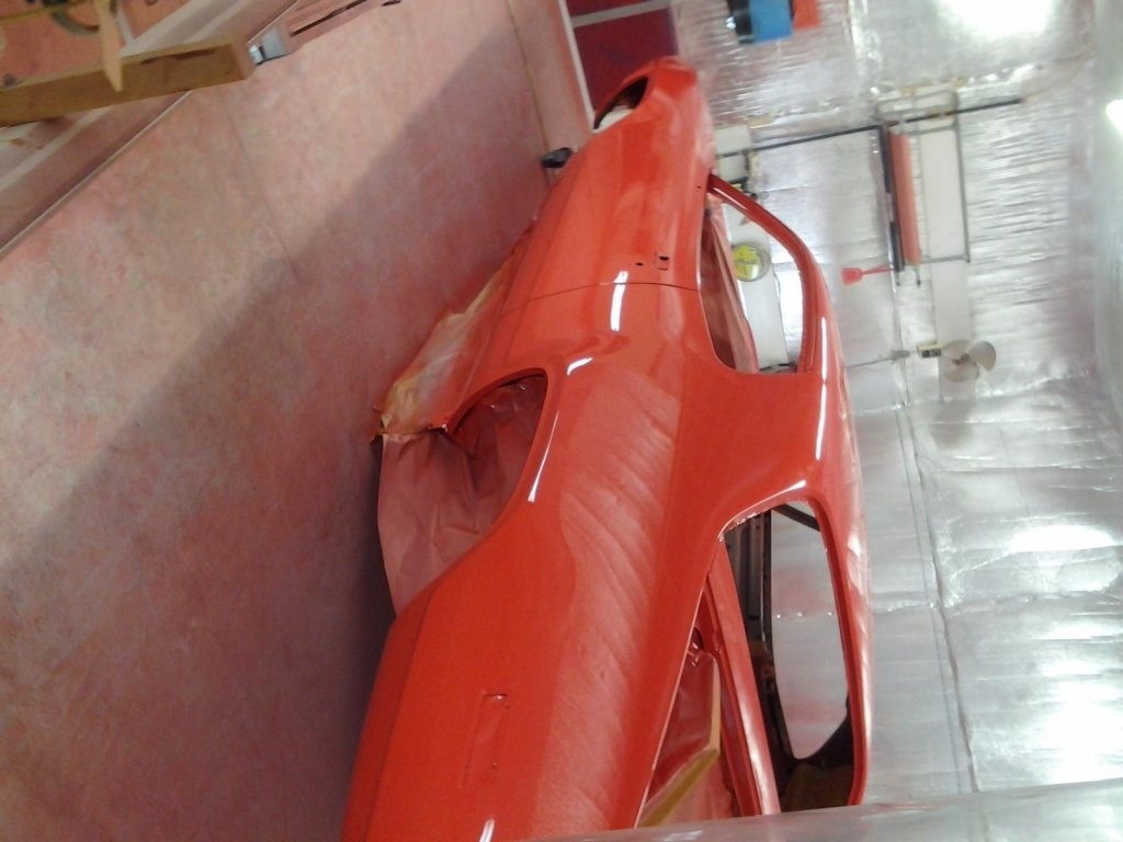

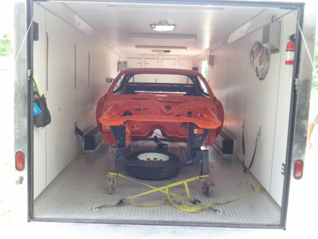

Now, with the help of my friend, he made sure my car made it back from the body shop since I wasn't home at the time
