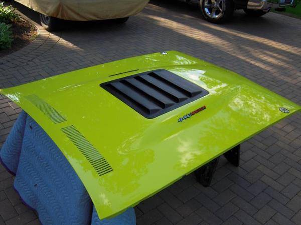

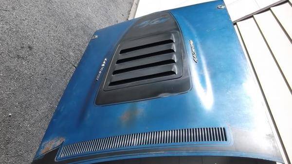

despite the buldge, the insert or plain look... these are the configurations of the grilles on hood
1st half 71
second 71 half and all 72
73
74 ( no grilles )
