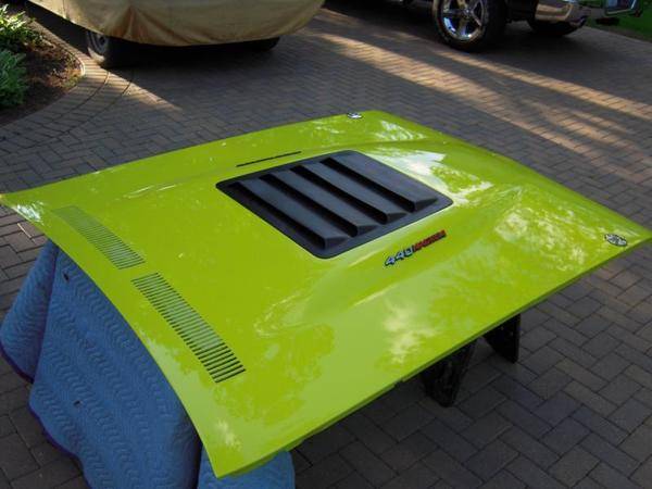

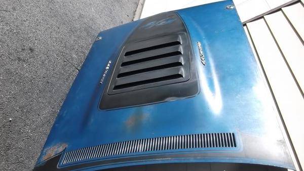

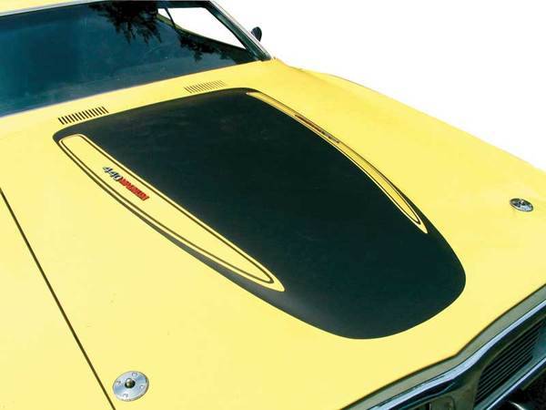

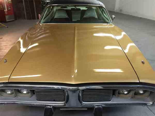

despite the buldge, the insert or plain look... these are the configurations of the grilles on hood
1st half 71
second 71 half and all 72
73
74 ( no grilles )

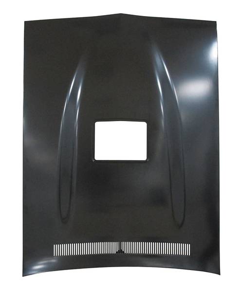

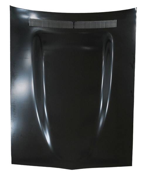

I just wanted to put this here... AMD now is making 71 ramcharger hoods and bulge hoods. Will fit all 71-4 Chargers, but might be incorrect for the year. Pictures and links:
I do think the regular bulge hood is priced too high, but the ramcharger price is reasonble. Especially when considering the impossibility of past structural damage and rust...
http://www.autometaldirect.com/amd-hood-rallye-power-bulge-71-74-charger-p-18987.html
http://www.autometaldirect.com/amd-...harger-includes-ramcharger-scoop-p-19945.html
They still have not hit the streets so we will see when they get them done. Yes its likely they will only do one style on the vents.

Agree on pricing for $100 more the working ramcharger door version is a MUCH better deal.
Interesting they chose to do the plain bulge version with 71 style vents, which IIRC was not an OEM option.
