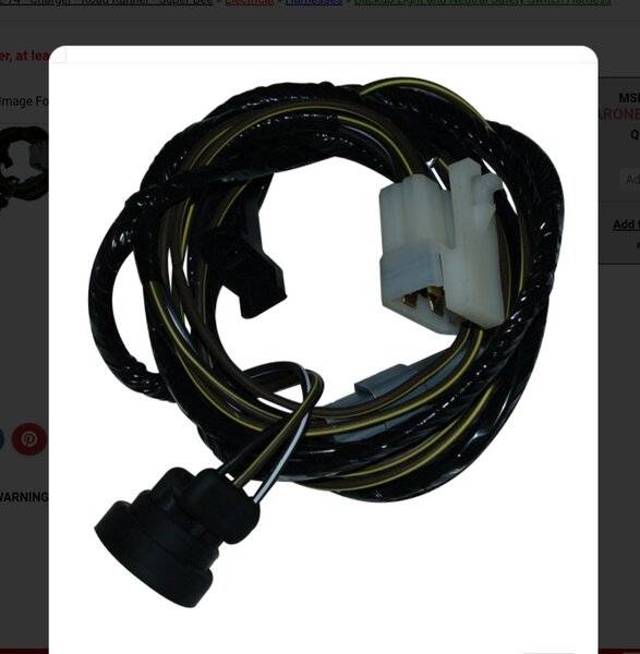

My 72 rr has some wiring issues I'm working through. However thought I would ask were the back up light switch is before ripping to many things apart.
Hi Ken,
The reverse light switch connects directly to your transmission, whether it's Automatic or Manual. 3 pin for AT & 2 pin for MT. The harness then runs to the bulkhead connector on your firewall, pins 7 & 8. Including a pic of the AT switch
Hi Ken,

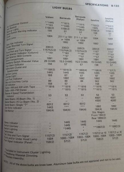

Jeez I hate bugging you, but do you happen to know what the bulb number is for the "fasten sear belt" sign is?
Found it thanks. Another question, does your Satellite have a light on the dash aswell as the dome?
My Dome light functions correctly, with the doors open, or the light switch rotated to the left. My Dash/Gauge lights are a work in progress. I have an aftermarket Cluster and gauges. I need to improve the Ground to the dash. I will run 1 or more 10 awg wires from the block and/or frame, through the firewall to the dash.
Never a bother Ken, what little I can do to help folks on this wonderful forum is a privilege as far as I'm concerned. I've gotten a lifetime worth of help on here, by asking, reading, and searching. Ask me anything you wish, and I'll do my best.
The fasten seatbelts (door ajar) indicator bulb # is 1892. This is for my Satellite, but I can't imagine it would be different for a Roadrunner. I'm including a pic that lists all the bulbs for the car. The only differences I see for bulbs, is between standard and rallye clusters. Again, this is for my Satellite and other Plymouth models, but I can't imagine there would be different numbers for Roadrunners.
