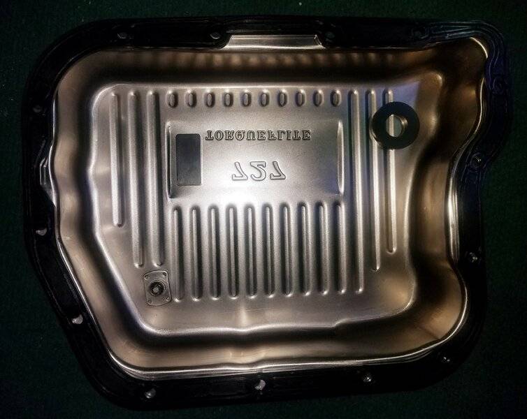

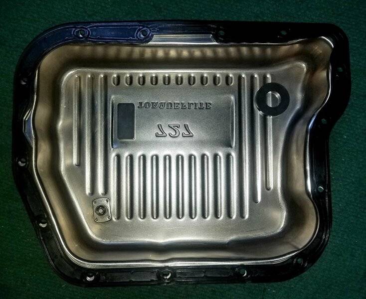

If you got the metal core embossed rubber gasket it's a good one. Aluminum pan or stamped steel? Steel pans need to be straight especially around the bolt holes.

You can install the molded gasket dry and tighten to 115 inch lbs per the factory service manual.

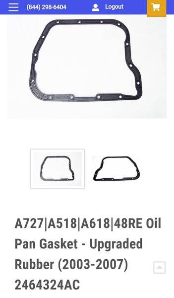

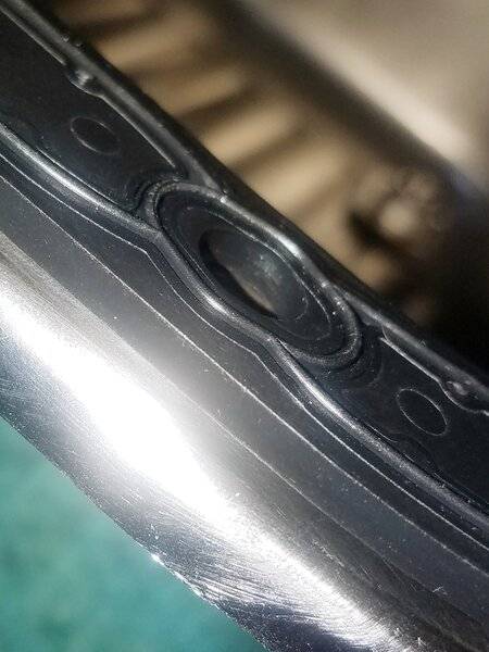

looks like he has the good Mopar gasket in one of his pictures, post 13, picture 3. He will not need any sealant for the gasket just bolt it down and go and it is reusable to. That is what I have on my transmission.
Steel, it wasnt cheap! Seems pretty flat still, I went over it with a sanding block to get the RTV off,
Yessir, Got it from Global Trans parts, the expensive one.
that guy didn't know what he was doing, putting sealant on the type of gasket. I've been using these gasket for years and never had any problems and I've had them on and off many times
