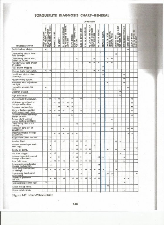

Decided it was time to separate the BS from the facts and did some research. This refreshed my memory and should aid you in disassembly as to what to look for.
For those whom wish dispute the validity of this info this information was extracted form from Chrysler Corp. Service Training Fundamentals of Automatic Transmissions and Transaxles TM-608-A.
