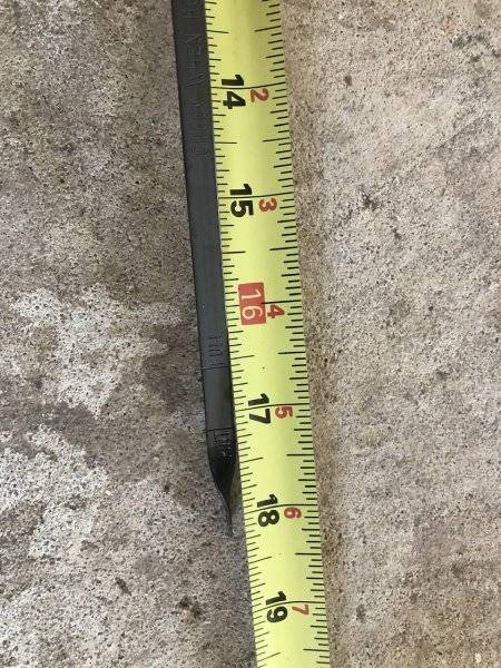

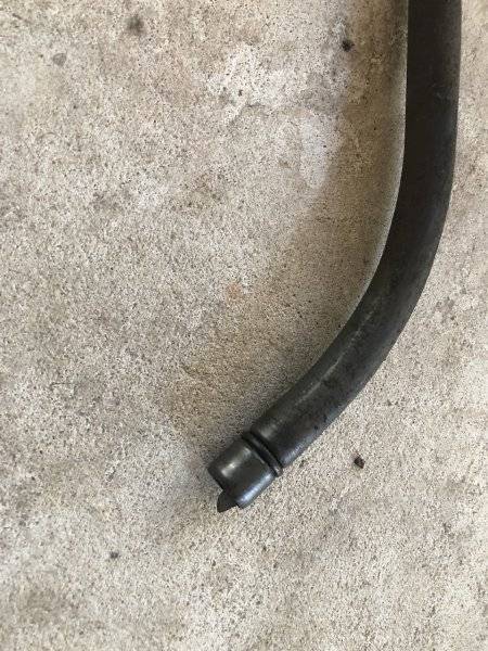

So because of the famous leaking dipstick tube problem I bought a Hughes locking dipstick #HP1235A for my 727 in a 1967 Charger. The car has a 1974 440 engine installed. After everything was up and running the transmission was leaking, a lot, around the tailshaft seal, the shift selector seal and the Hughes dipstick tube. The fluid level was correct according to the Hughes part. I discovered a discrepancy between the “full” mark on the Hughes setup (orange pencil) compared to the stock parts (green pencil). My fluid level is at least an inch higher when measuring with the Hughes parts. Anyone else
notice this? I’m thinking it’s the source of my leaks.

Agree, I checked one of mine on the shelf and the dipstick barely protrudes out the tube. The locking dipstick looks fairly accurate compared to mine based on the pic.

The car originally was a 383 and the 727 transmission, and tube, are original as far as I know. The original tube is a bolt on. I bought the car in 1987 and it sure looked like original rust, grease and filth. Numbers on the rail are H2801543 3306790. I measured the Hughs dipstick full mark from the trans end and placed the orange pencil where the mark is in the tube. Thanks for the help!

My Hughs part and the original. Tube is bent differently and different length so there is no direct comparison.

I found a half dozen or so dipsticks here, including a brand new one from A&A that list the application as every 904/727, regardless of year. They are all identical lengths to the full mark. I did find that the older ones have a difference in what's acceptable as far as the "ADD" range goes, but other than that, they were the same. A couple had OEM Mopar part numbers on them, others did not. I would be real curious to know if theres a part number on your original....since it really looks to me as if your trans was running almost a full 1-1/2" low on fluid as opposed to the norm. ALL the sticks I have would put your fluid level at about 1/2" higher than the O-ring on your orange (original) tube. It would appear that the Hughes unit is indeed correct..... look below in the similar threads... Snook confirms this information a year ago!!
