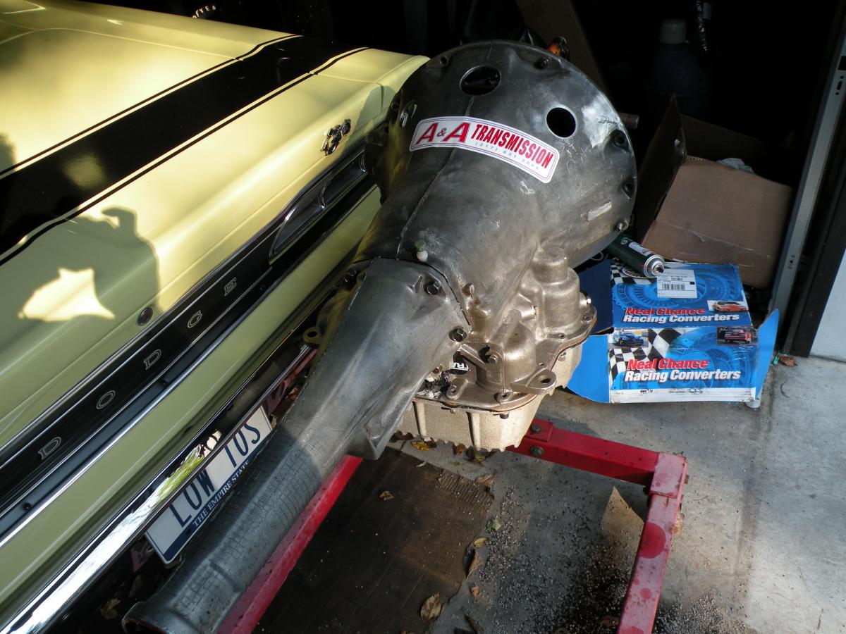

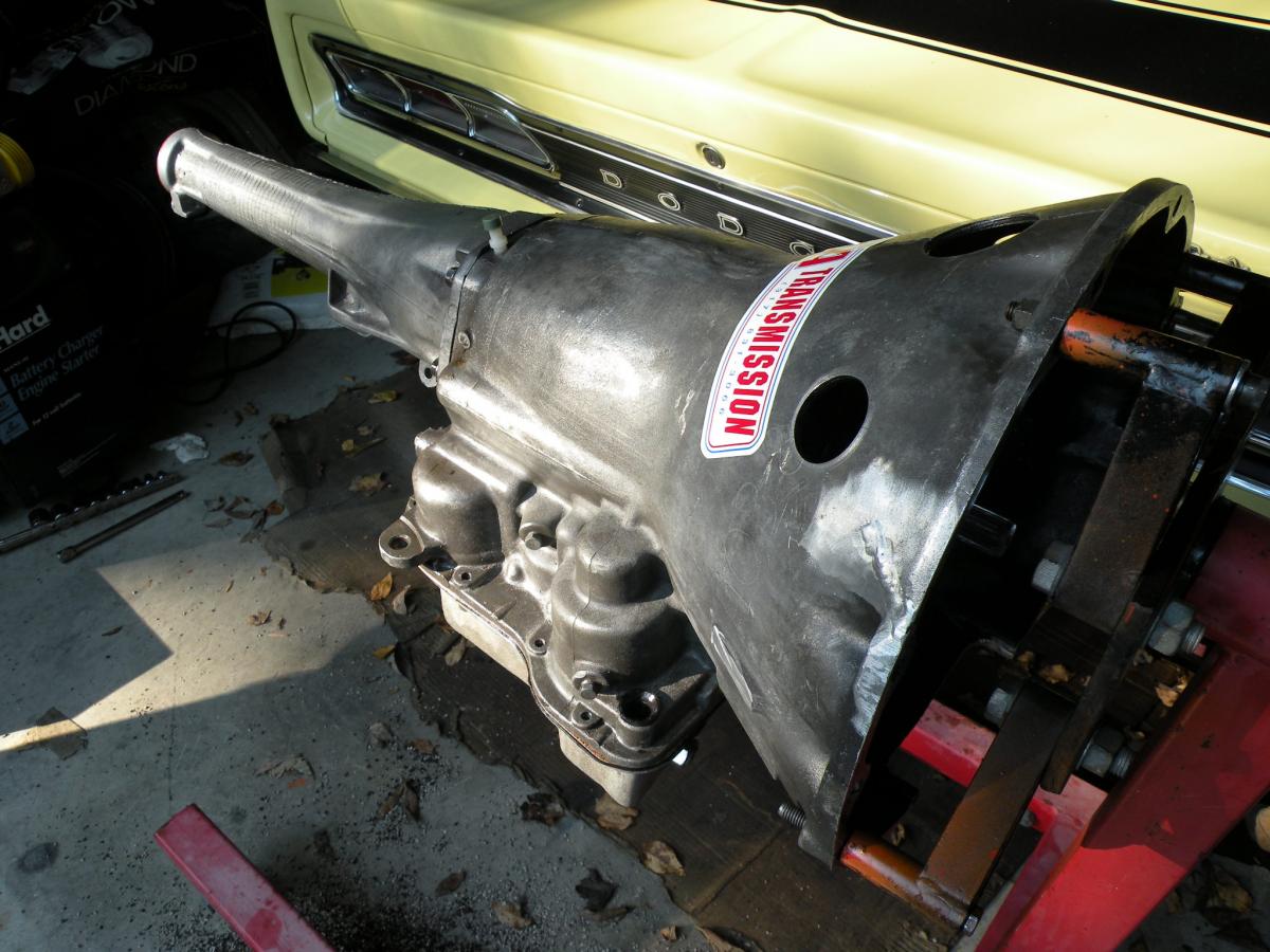

a billet steel or aluminum drum is $550.00 alone. do you need it no. but do you like your legs?
super sprag $175.00
i had a trans done with just rollerized planetaries and it was $1200.00
my trans, in my 850 hp hemi was $2500.00.
the one in my 65 black dodge was $6500.00
my pushbutton trans. in my 63 plymouth was $1750.00
i want to do it once and forget about it for awhile.
