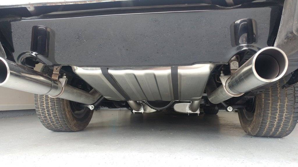

I found some 3-1/2" chrome tip on Summit Racing I like. I shorten them about 5 inches since taking these photos.

The exhaust is awesome! Loud but deep. The drone is brutal at 1800 but eases out above 2k. Above 3k, I feel the exhaust in my lower back more than I hear it! Very cool.

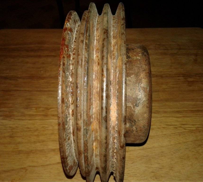

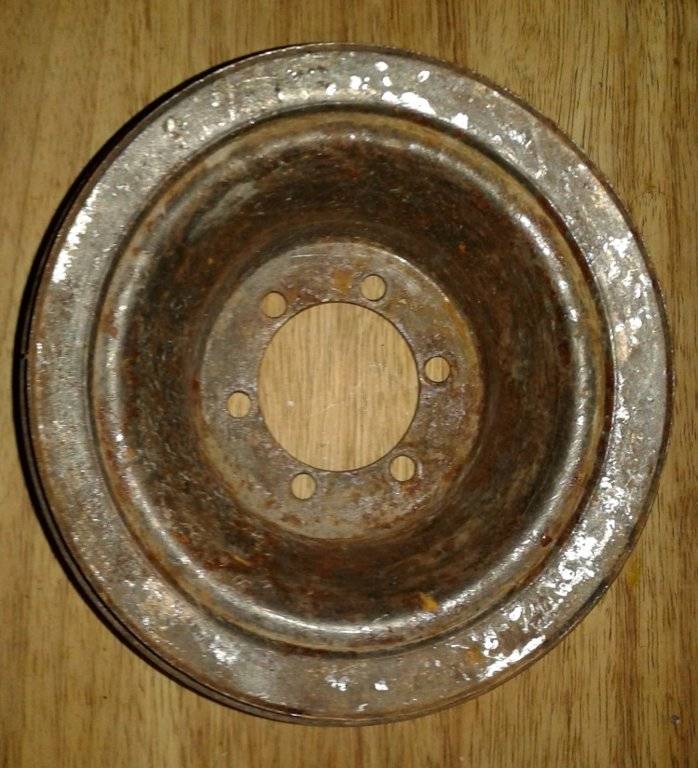

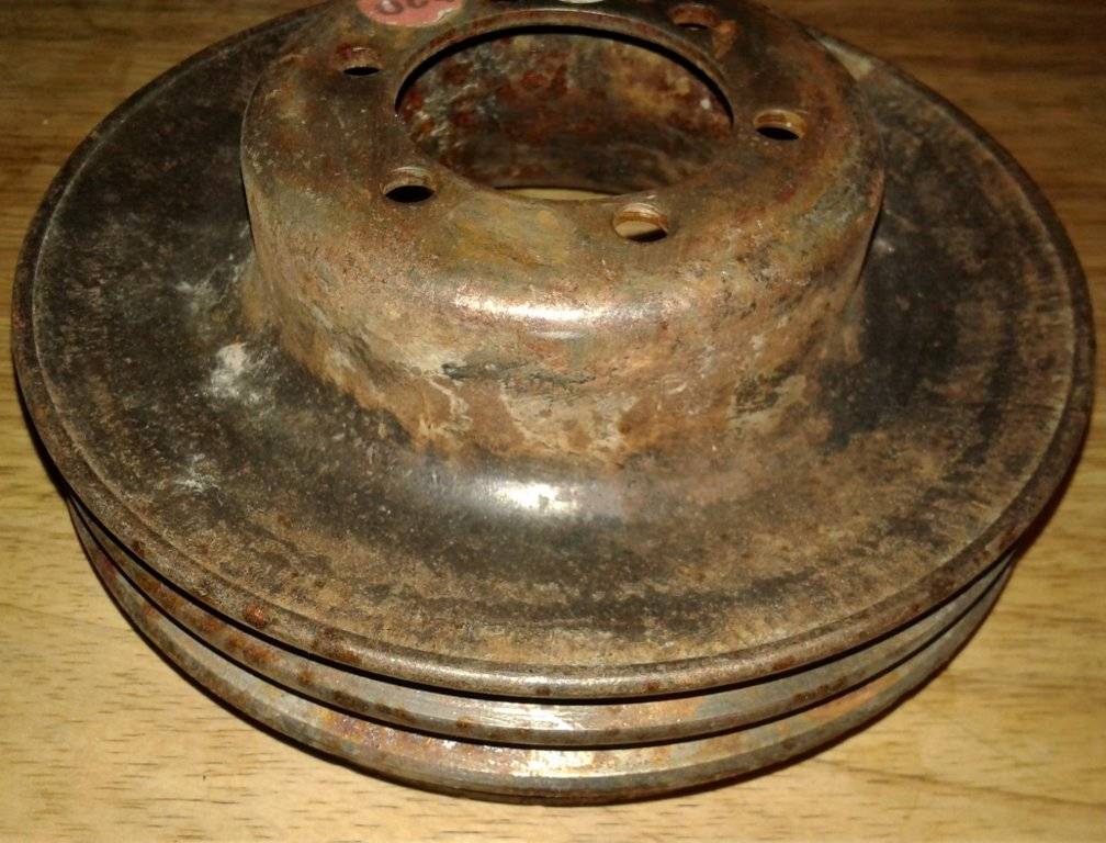

No AC compressor failed. The lower crack pulley is too big. The ALT belt hit the water pump bolt. I need a 7" or smaller 3 grove pulley to make it work.
Current state:
I have this 3 groove crank pulley that's 7" diameter with the outer groove being stepped down in diameter approximately by a 1/4".
Does this look like something you need?
Thanks
Thanks
So, 7" on the two inner groves and 6.75" on the outer? That just might work. Let me run the number to see how it will effect things.

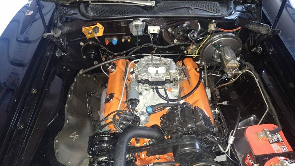

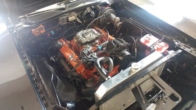

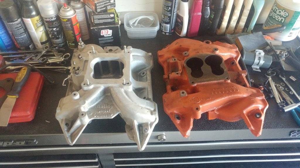

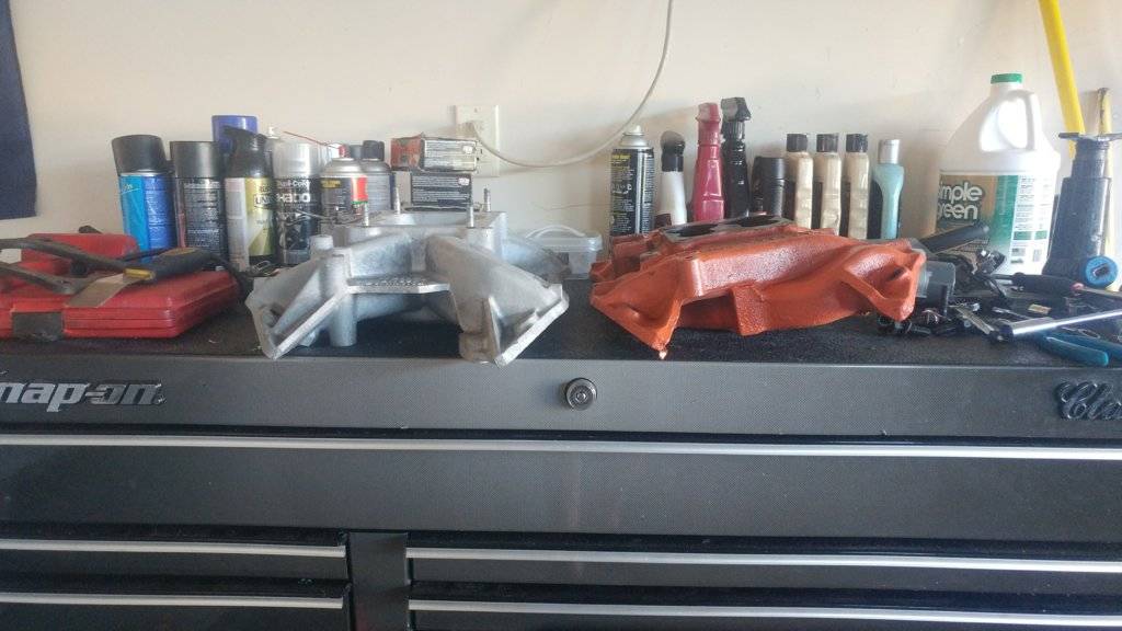

I bought a Holley Street Dominator from an old timer Mopar man that absolutely swore by the Holley SD. He had four of them. One on a 451 stroker in a '55 Plymouth, one on a 383 in a custom, and two on the shelf. One was painted and the other was port mapped. I grabbed the port mapped one.
Installation was super easy. It was as if the intake was actually designed for a stock 383 with a Thermo-Quad! I know right?! Crazy stuff. I'm so use to the "fiddle with it until it somewhat fit" nature of Mopars, that I was beside myself installing the intake last night.
Pics:
Holley Street Dominator verse a stock '73 400 iron intake
Review: Hot Rod Maganize said the the intake loses 40tq below 2k and gains 50hp above 5k. My super reliable butt dyno confirms this to be correct. The engine can just breath much better with the SD verse the stock '73 400 intake. The idle is a bit rougher. The exhaust has more "pop" to it. The brutal drone at 1,700 rpm is even worst. Throttle response is WAY better. The engine bogs from 1,000 to 2,500 (because there's low air velocity at that RPM), then it kicks in hard around 3,000 and pulls like crazy all the way to 5,800 before the can or ignition falls on it face. Low speed driveability is also improved. The car had too much torque down low which made it hard to drive at low speed.

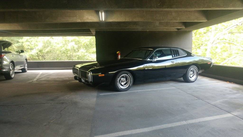

Here's the Charger in the parking deck last September.

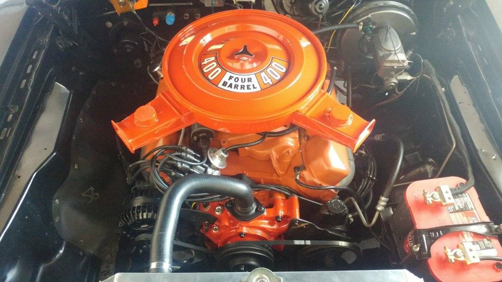

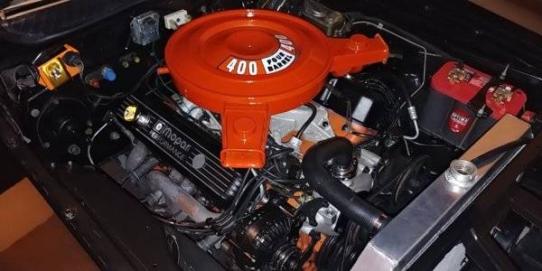

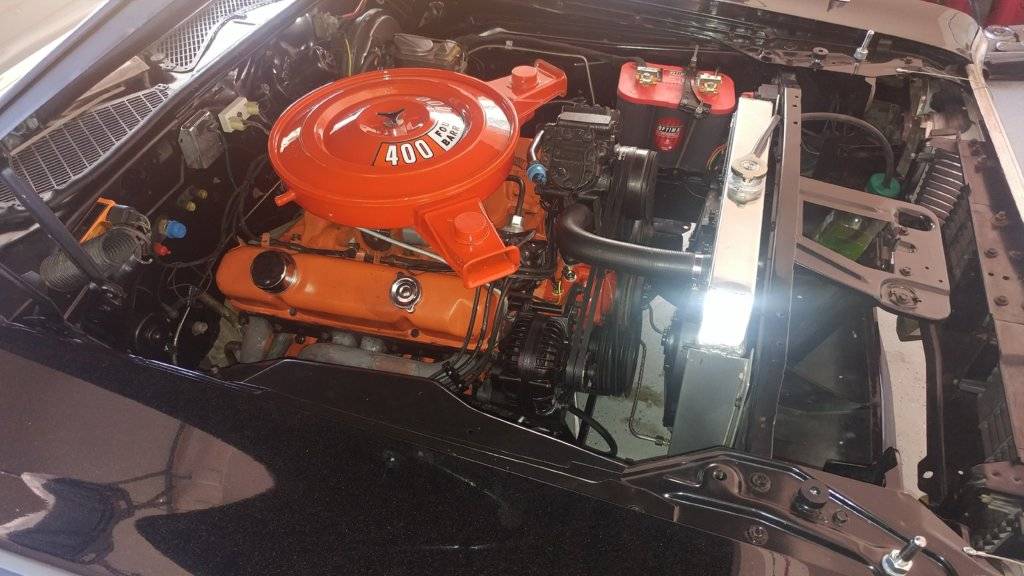

New valve covers and water pump housing. The old housing was so rust pitted that the gaskets couldn't seal it up. Funny thing about installing the housing was the fact that every time I picked up the new 5 pound housing I was picking it up like the old 40 pound housing. That made for fun times! Didn't toss it across the garage, but I came close a few times. And we figured out that the AC compressor weighs a few pounds more than my 8 year daughter.
...and I still need to sort out my pulley problem.
