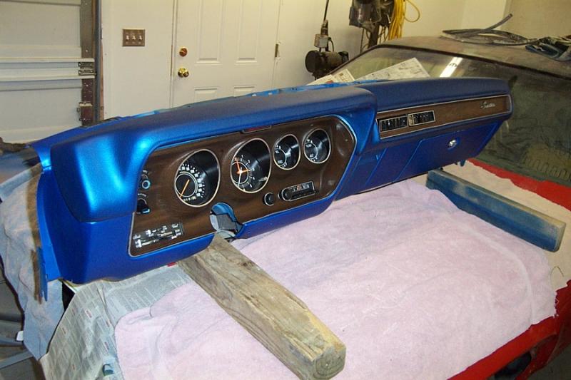

72Fourspeed asked me to post some pictures of the cap in my car and they are below. I've been driving these cars since 1979 and visually the caps are identical to a vinyl cap. When you feel them you can feel the difference between a hard plastic surface and a soft vinyl one, but visually (which is what counts unless you have a bizarre vinyl fetish) you can't tell the difference unless you climb under the dash.
