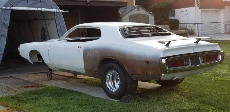

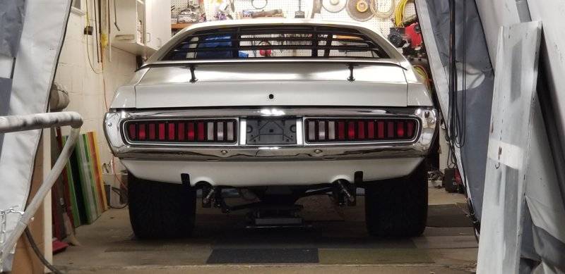

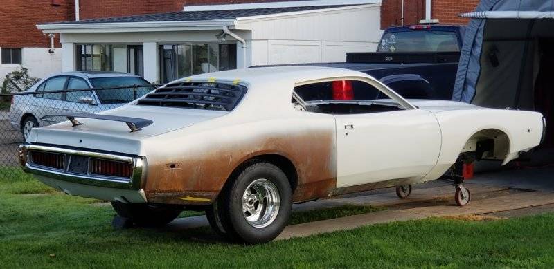

well....wile working on the stock 8 3/4 I somehow was bitten by the fat tire bug ,
I ended up walking away from the stock and went with a moser engineered 8 3/4 with back brace narrowed 8" , magnaforce (do not recommend) pro 4 link kit and did a mini tub to fit a 29x15x15 mickey Thompson sportsman s/r on a weld drag star 12x15 rim I probably have enough room to run a 31x16x15 ..

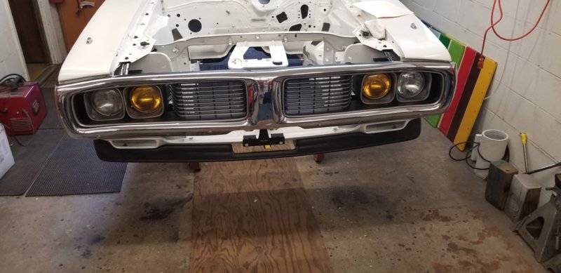

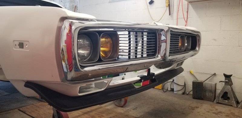

Hung the front bumper by myself, needless to say my neighbors learned some new words that day ..but it's on, and its close, and I have all the parts :) since I bought the car disassembled, I figured I should try and build it before body and paint ..
Headlights are still a little off ,grill inserts need tweaked , nothing that a day of tinkering cant fix on the final install ..
I tell you, it's freaking awesome how the post started looking like just some dude farting around in his backyard then BAM! Completely stripped frame! Then WHAM!! Professionally painted frame! Then comes the rapid fire of baddassness! fat rear tires, four link with track bar, chrome bumpers, and power dome hood. Can't wait to see the engine.
Thank you so much for that ! ! It really dose mean a lot ..I'm doing as much as I can by myself, one to save on cost , two because I love it ,the building , learning ,research and so on ..but having help to hang the front bumper would of been nice ..

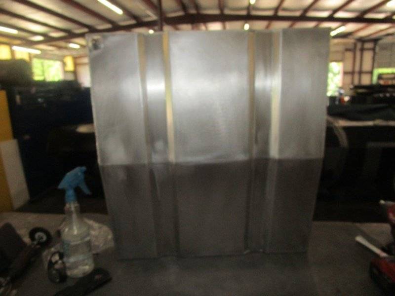

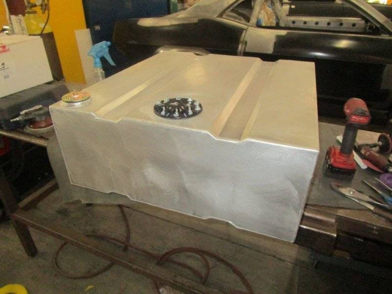

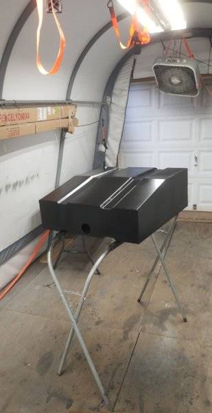

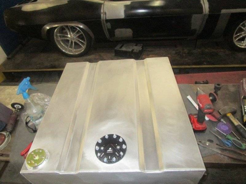

And oh yeah , new efi xl tank showed up , drying right now .. :)
With a areomotive flex 450 stealth pump .
IMG_2048.jpg IMG_2049.jpg IMG_2050.jpg IMG_2051.jpg received_306616893443031.jpeg

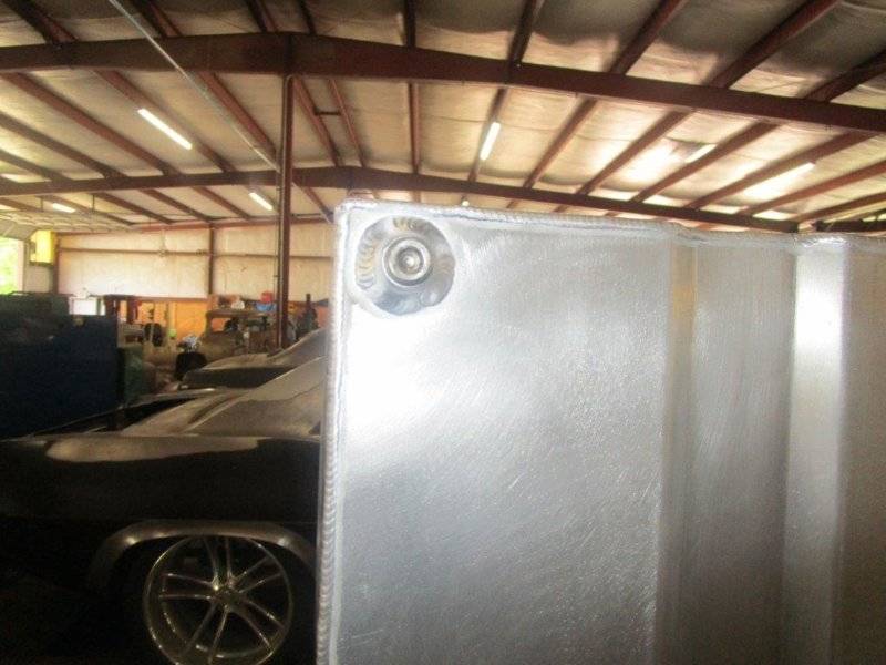

just an update , charger project got put on hold for the winter to do a smaller Harley project ,
but i did manage to get the fuel cell in and next up is fuel line routing challenge , pics coming soon..
