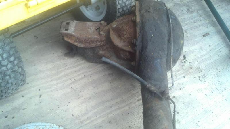

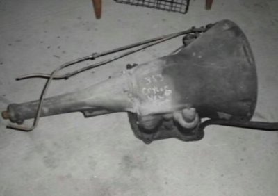

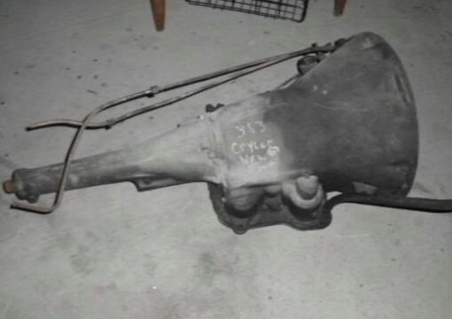

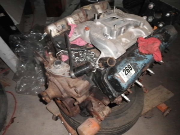

Here we go some pics of the stuff I have got already. 440 with intake.jpgrearend 1.jpg727 tranny-1.jpg

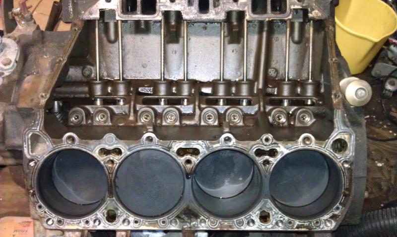

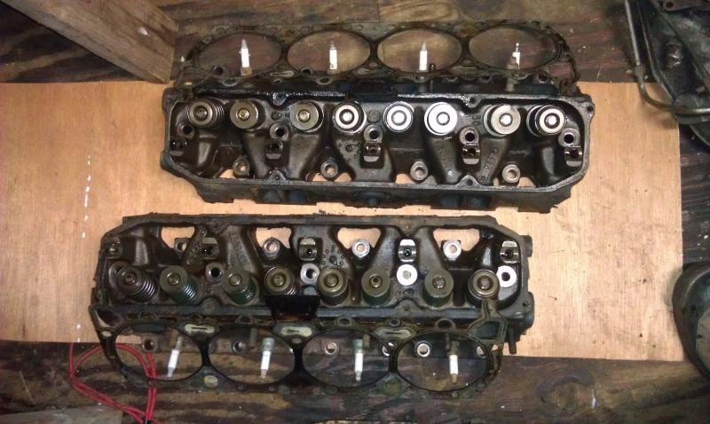

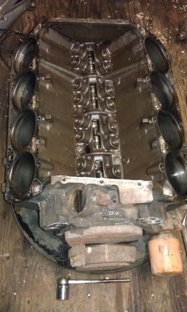

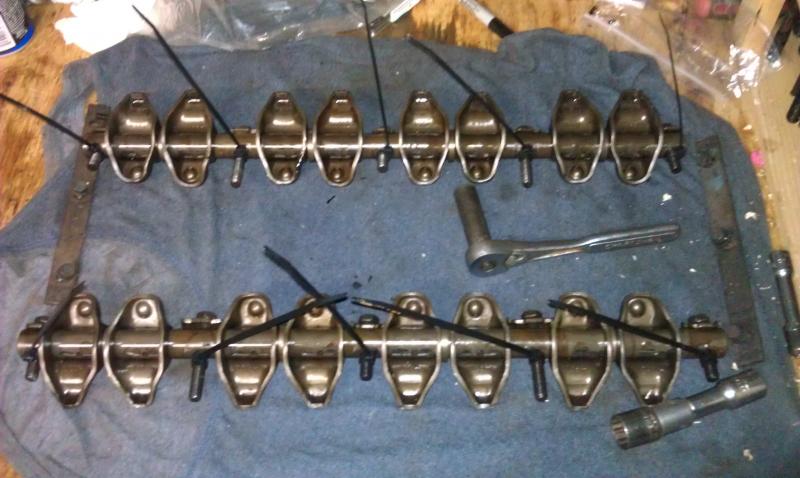

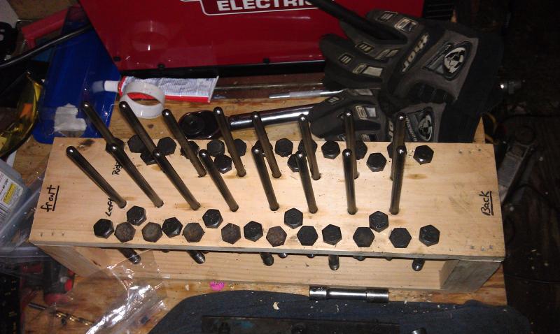

Here are some pics of what I got done tonight getting the engine stripped down as I want to get it all to the machine shop soon. Everything looks pretty good for the most part the wooden thing is a holder I made to hold all of my pushrods and head bolts in their original positions in case I reuse them ENGINE TEARDOWN 1.jpgENGINE TEARDOWN 2.jpgENGINE TEARDOWN 3.jpgENGINE TEARDOWN 4.jpgPUSHRODS HOLDER.jpg

I hope so I will be washing sandblasting resealing and finally repainting the new rear end some time in the next couple weeks. I will also look at the brakes on it to see what needs to be replaced . The rear end also came with the rear sway bar which I am missing as some one removed it and never put it back on as well as some leaf springs. I think I will sand blast and paint all of these as well.

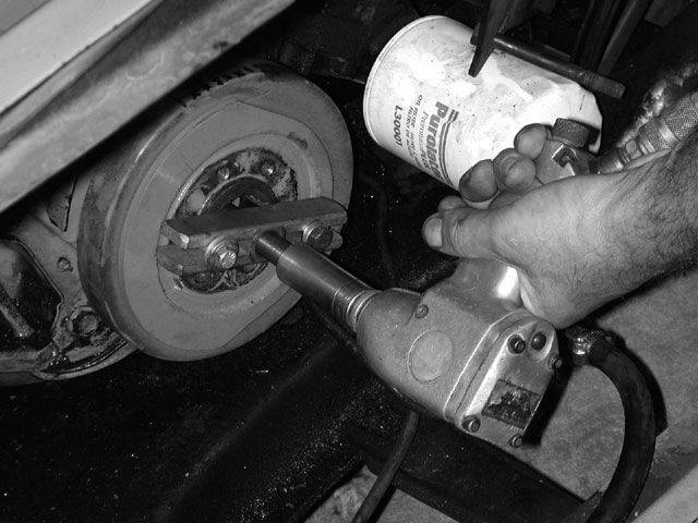

Hey quick question I still need to pull the damper off will I need some sort of puller to do this.
Yes, you will need a puller. A quick google search found this image from a MoparMuscle project that shows one type of puller in use. I have not use this exact type of puller for this but it looks like it would work fine. Just don't use a jaw puller that pulls on the outside diameter, that's likely to ruin the damper. Cool project by the way, keep us posted.

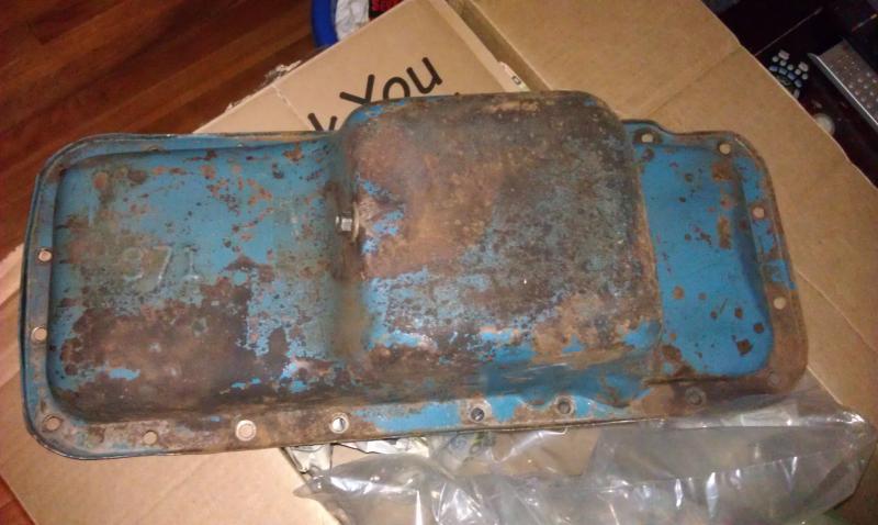

Here we go another piece of the puzzle arrived tonight was sitting on the porch when I got home. It is my 971 oil pan the one I need to use to put my 440 in using schumacher's motor mounts to hook to my sb k frame. I found it on craigslist and thought for sure I was gonna get ripped as he would only ship if I mailed a money order. The price was so much better than the others I found so I took the gamble and it got here quick and for only $50.00 shipped I'm not complaining.971 oil pan.jpg

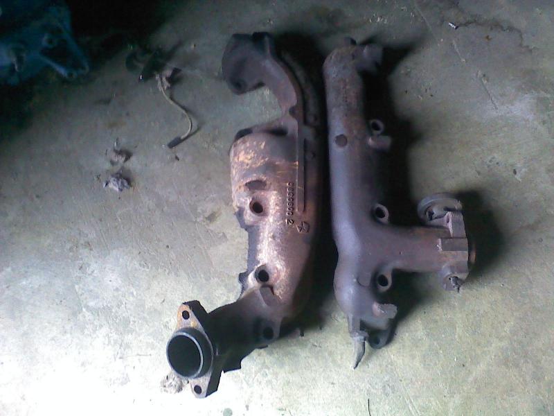

So I'm trying to figure out what I'm gonna do for manifolds I would really like hp manifolds but can't seem to find some for a decent price. The guy who sold me my oil pan has a set of manifolds off he thinks a 76 new yorker and he said he would let them go for 40 for the pair and ship them for about 40 more. Here's a pic of them not sure if they would even work for me though. 76 manifold.jpg
