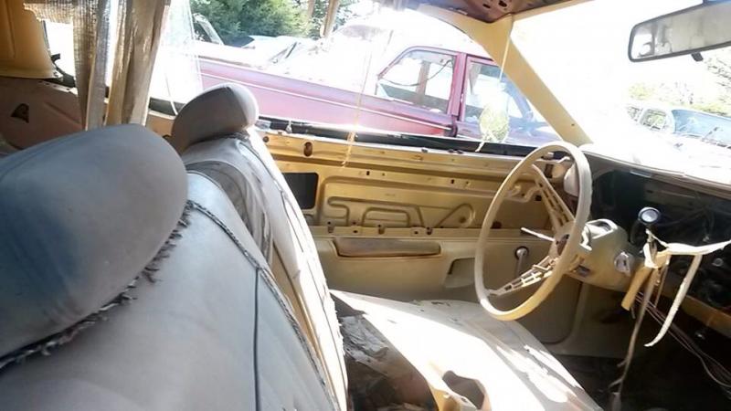

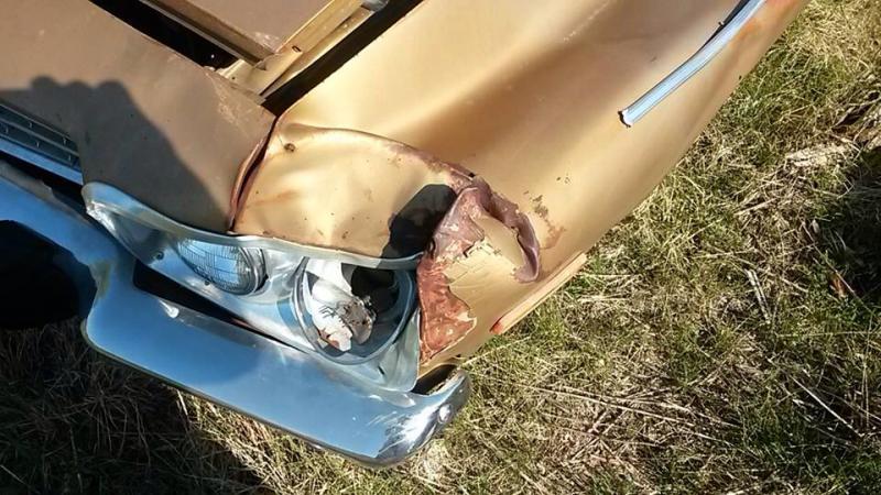

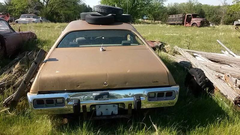

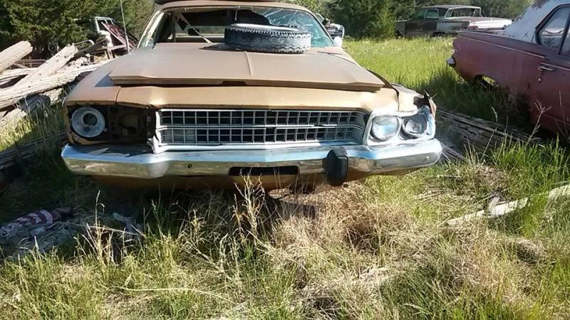

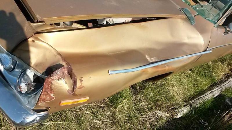

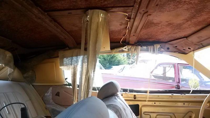

I traded a motorcycle for a project car... And far as i can see, I have my work cut out for me. Car is a 73 Plymouth Satellite Sebring. Here's what I know about it...
Originally a 318, automatic, A/C car, unsure of axle I wanna say 8 1/4, shift on the column, etc. Car is tore up, mainly in the interior. Outside body isn't that bad, but The drivers side fender, and the "header panel" is trashed. Theres some rust about the wheel wells, and the drivers door has a dent, and shes a biggen.

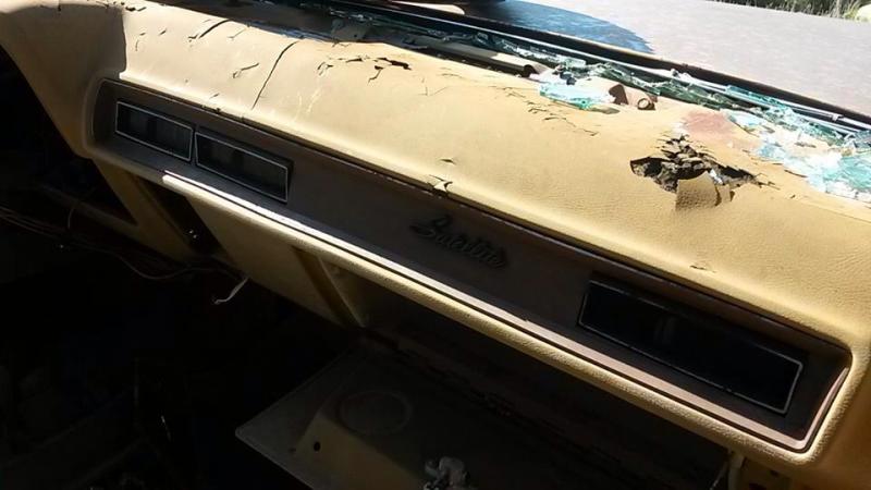

INTERIOR
The RAM gauge cluster will be modified to fit as I want. I'll be making my own dash out of fiberglass and vinyl or maybe even use microsuede. The car's interior was originally gold...Yuck.. Going to try and start upholstery and make the interior black with green accents. That and ALOT of custom interior work, It will have a console shifter (a ratchet shifter of whatever I feel like at the time). Main question is.......Does anyone have any idea what materials I could use that would save weight? Obviously Carbon fiber would be the ultimate way, but that all seems expensive and I couldn't do it myself. Oh and front buckets to replace the bench.

Do you have a budget in mind for this? Have you looked into the availability of body parts?

So I have a list of some parts I'm going to be buying, but my main snag is the Mopar performance computer #P5249545. I can't get many details over the phone from Summit, But I'm just wondering what sort of gains I can expect from it? Other things are the Hughes Air gap intake and Big gulp throttle body, maybe a 100 shot of juice, DUI ignition system, a cam (don't have one set yet, but it has to be computer compatible, not sure what the limits cam wise are with the computer), dang it i don't have my list here next to me, but anyways without "the juice" I'm looking at only 1600 in parts. I set a low budget of 5K (I have a buddy that's going to shoot the car for the cost of materials) I will update the parts list when I go grab the paper from the truck lol. Anyone know what Mopar City generally charges for a fender and some trim?
Here is a email you can check quicker to get a price but im afraid you may want to put an ad in here for what you need as Mopar city is pretty high priced from what ive seen, it wont hurt to ask though! Good luck...
