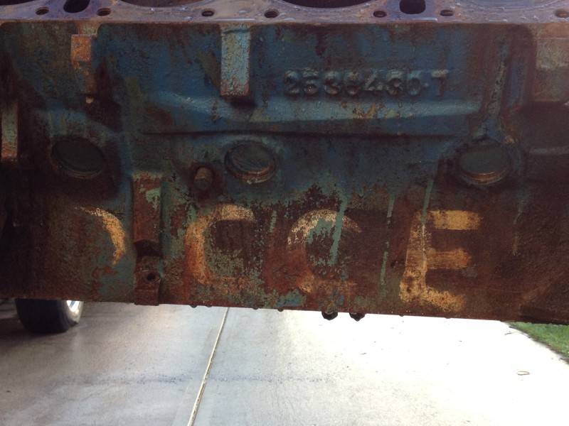

Those white letters are factory aren't they?

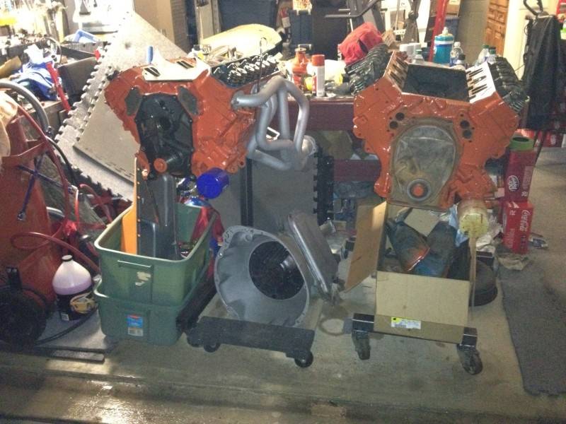

The 383 has the headers and the 440 doesn't. Ignore the mess had to move stuff around to make room...

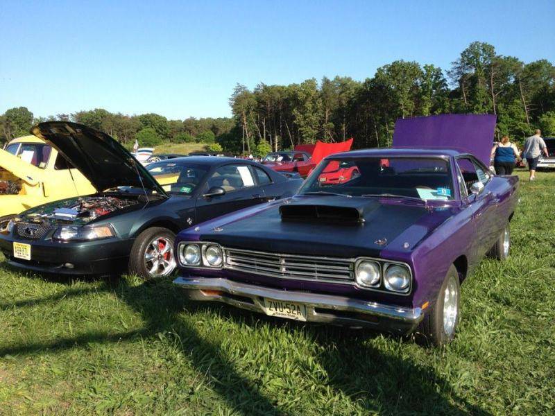

Wow that car looks really nice. Could you post some pics of the Purple A 12 clone 69 RR? I may paint mine that color, and get a F/G hood like you have. Those pistons in the 440 look pretty low compression. I understand the 69 440 - 6 pak engines had the highest compression. Thats due to the fact that the C/H is higher. Piston top comes closer to the deck of the block. And they are flat top. Which ones did you get?

Thanks Gary, I do have more pictures around here. Here's this one,

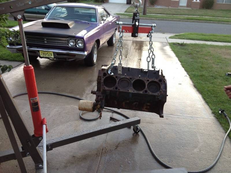

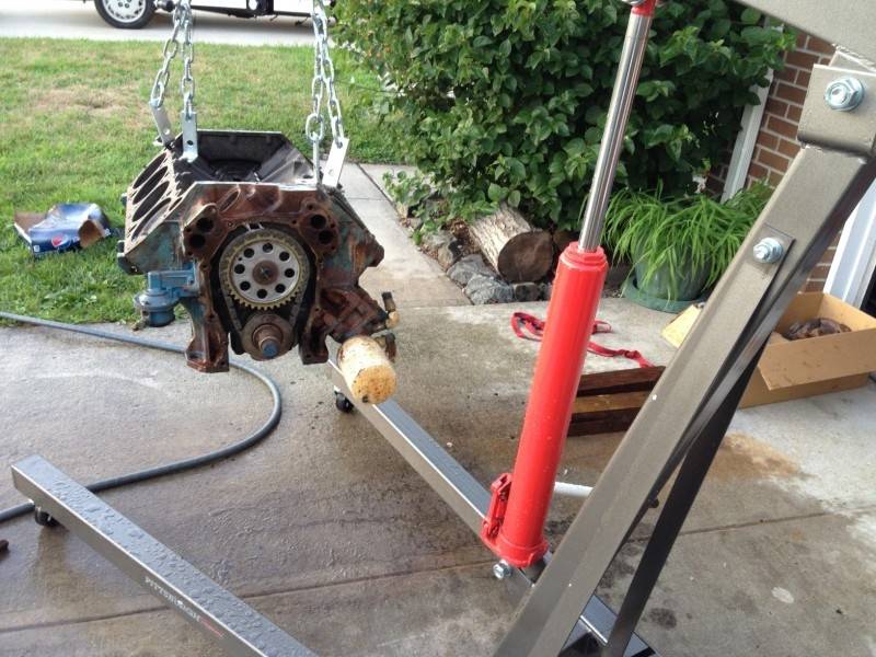

69bee, Thanks for the info if I use the heads I will be replacing those otherwise I was going to use the already rebuilt 906 heads sitting on the 383. In the first picture you can see we were flushing it, it still needs a lot more. I called it a night after the water came out pretty clean, it had a lot of rusty flakes and handfuls of corn came out... mice must of stored up for winter...
