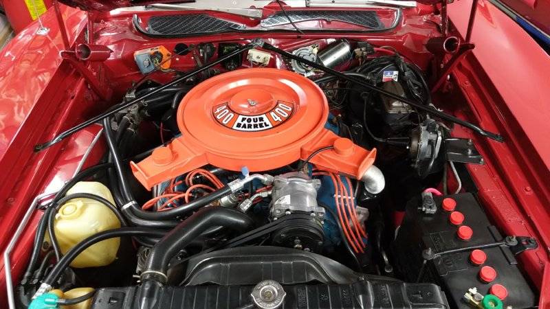

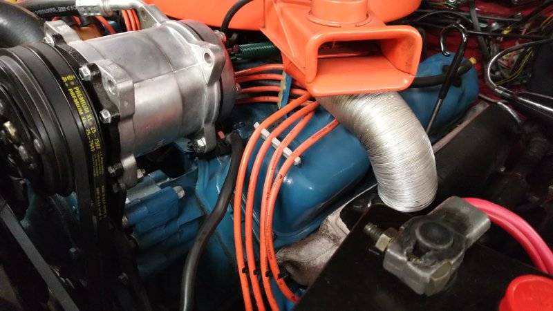

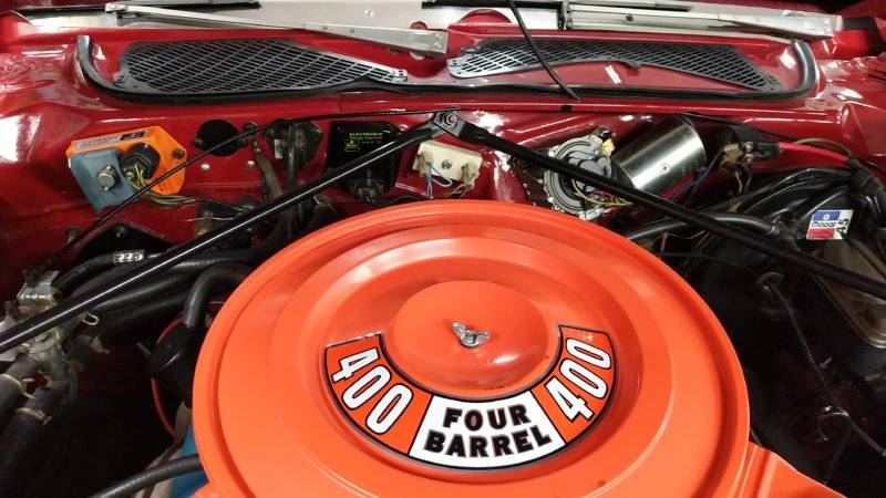

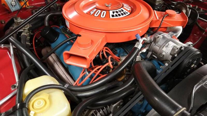

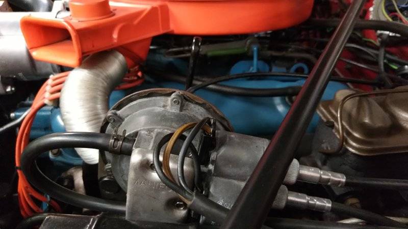

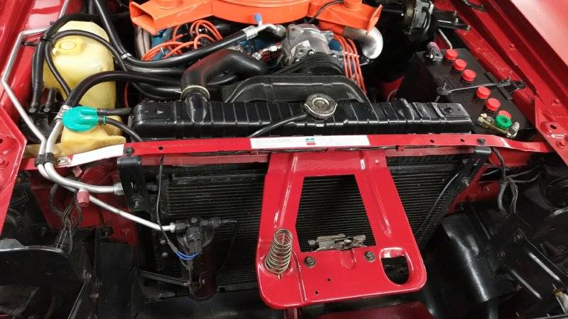

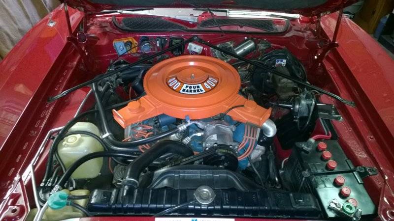

View attachment 839877 Several of those are pictures I took of other cars at Carlisle while I was getting mine connected. Some one routed their engine vacuum line to the booster through that, don't know why. My car is actually the first 2 pictures.
As far as the length, that's what the parts book says, if yours are shorter and they work, it shouldn't be an issue. One thing I can tell you is the one that goes to the transmission routes funny and a long way around to avoid the exhaust pipes heat etc.

Nacho is correct, those do not look long enough from the picture ... call them and get measurements.
The Mopar ones were not only listed incorrectly in their catalog, even the ones they SAY were correct were not long enough, that is why I had them routed the way I did. As I said I found an NOS set at Carlisle for cheap as it was missing the coil wire (so what).
