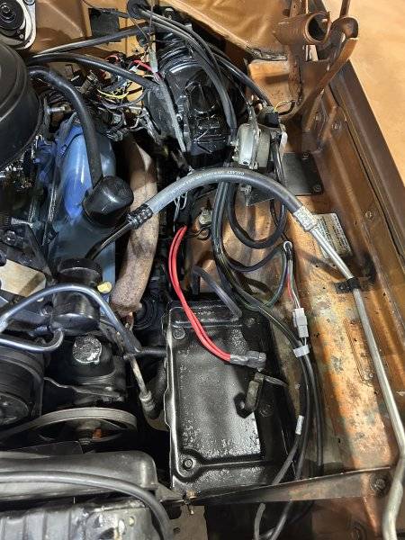

I’ve bought some formable heat shield and encapsulated the servo to help protect it from the heat that it is always getting saturated with from the exhaust manifold. I have no idea if that is going to keep it from burning up, but it is so cool to have Cruise control working on my 73 charger.

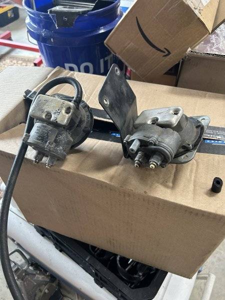

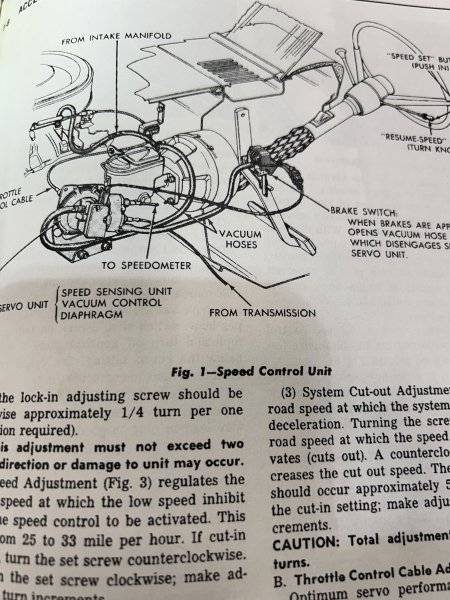

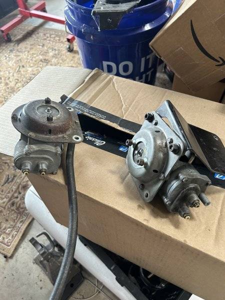

My question now is why the cruise control unit that came with the car only has provision for one vacuum line when the diagram shows two lines and the brake cutoff switch has a hose running into the engine bay? Is it the wrong unit? I have a 2nd unit off eBay that has provision for the second line.
Im sure the dual vacuum port servo ended in 1969 and the single vacuum port servo began in 1970. As I had both 69 and 70 chargers with speed control.
