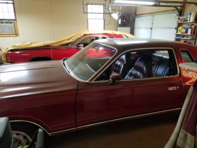

Interest in selling comes and goes. A bit low at the moment as I've gotten back to finishing the other one. Bought it from a consignment lot in Allentown around 98. Previous (original) owner was in Philly.

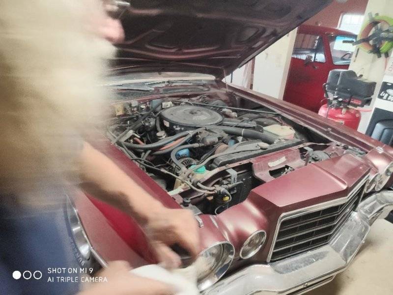

Has been a pretty productive summer getting "the evil twin" back together. Still a few things to finish up but fired it up this morning. First time in you don't want to know how long and it was very happy about it.

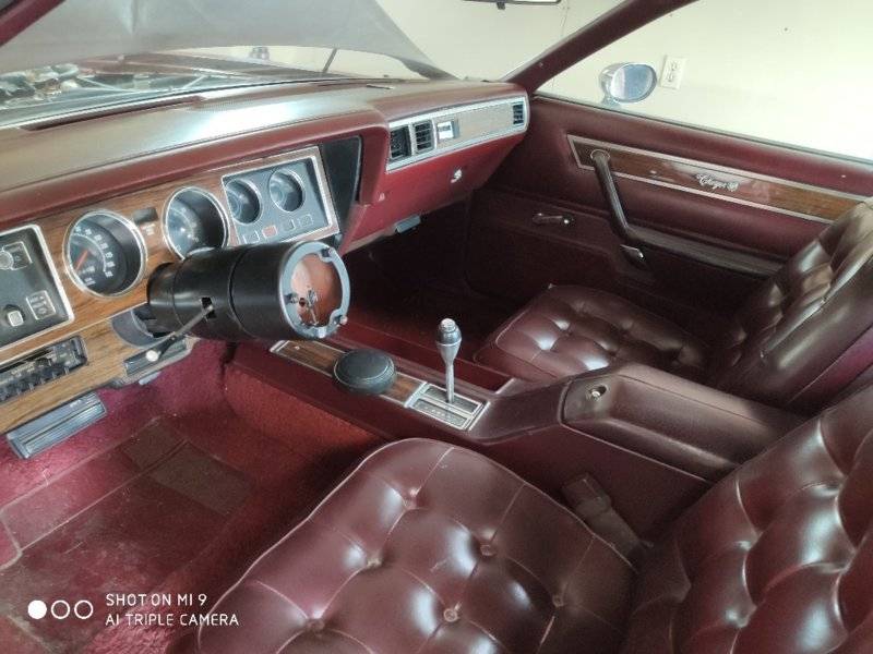

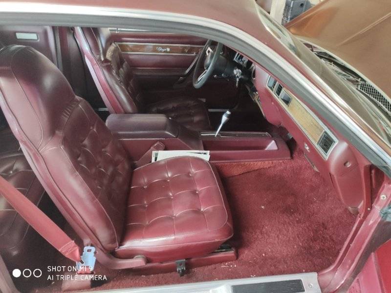

They're both manual windows, manual locks, a/c, vinyl buckets, floor shift and 99% original interior.
The survivor was built with slap stick and tuff wheel. Added a slap stick to the twin, almost finished cleaning up a tuff wheel for it and swapped the dash.

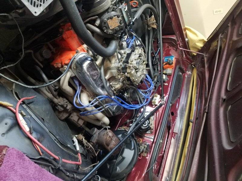

They were both built as 360-2, 904, 2.45 8.25 open, 11" drums.
The survivor is "as built" right down to the emissions controls and is still running a resonator. The twin has an MP crate 360 LA, 727, headers and cherry bombs. Also swapped in a 2.91 SG 9.25 with disks from a 75 Imperial.

View attachment 849102 View attachment 849105 View attachment 849110

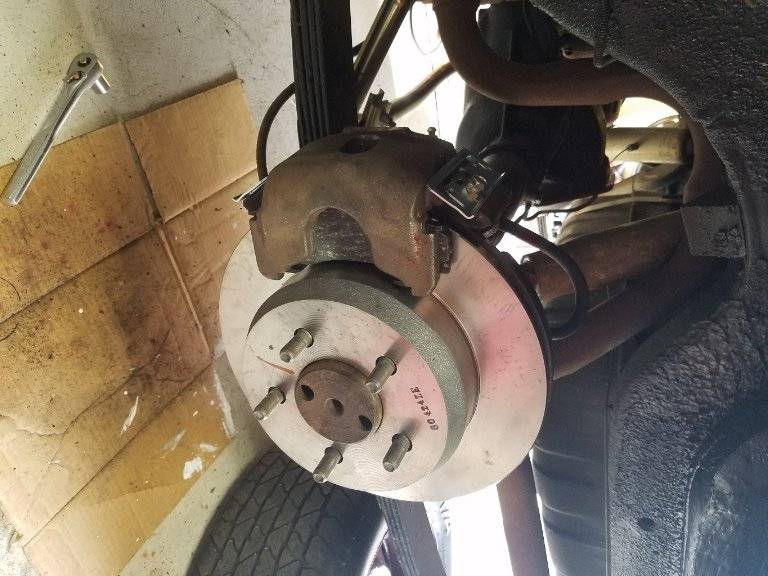

Way back around 1995 I picked up a pair of NOS rotors and NOS calipers through the dealer locator system. Finally got them out of the box about a week ago.

Probably didn't need the unique part number rear disc calipers as they're nearly identical to B body front calipers and the B body pads fit perfectly. I had the parking brake shoes relined because trying finding a set of those. The real fun was adapting the brake cables to work and still don't have that 100% dialed in.
The C body setup is pretty much like the trucks from the same era. A single pull cable down the length of the body, unequal length axle cables and a bracket arrangement to tie them together. B bodies use an off center front cable to pull the middle of a long cable that runs down each side of the body and equal length axle cables.
If I had saved the body cable from any of the C body donors it likely would have been too long and dunno how I could have tied it in to the B body front cable. To add to the fun, the passenger side setup is identical to the drivers side setup so it faces the other way around. Long story short: Original C body axle cable on drivers side, original B body intermediate cable, a 10" intermediate cable from a 2003 Lexus as an extension, passenger side axle cable from a 1980 GMC Van.
Been playing around with the parking brake shoe adjusters, which are mostly identical to a drum brake adjuster, and the cable length adjusters to get the foot pedal travel right. The last hang up is the passenger side not releasing 100% and pretty sure that's the body cable binding up in one of the guides but am beginning to wonder if I have enough cable spring on that side.

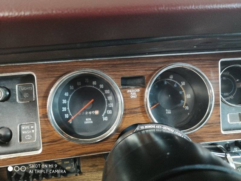

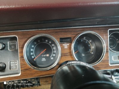

I see you're in the factory tach club. I have one in my 77 Fury which I believe was factory as I got the car from auction in 1981. Love the Daytona, especially round headlights and floor console

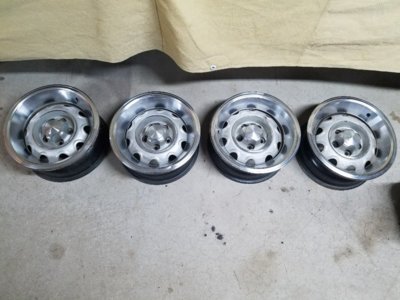

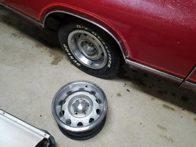

I had the evil one first and it's kinda why I couldn't resist buying the survivor when I stumbled across it. Before that I put body color matched cop rims and found NOS cop car dog dishes. Trim ring TBD but was ok with the extra polycast ones I had.

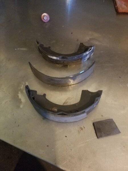

Adapting the parking brake on the Imp 9.25 disk to the B-body cables was fun and for awhile I was convinced a weak spring on one end. After going around the block I checked my new relined e-brake shoes:
Thanks for the information on the Imp. disk brake issues. I picked up a 9 1/4 with Imp. disks brakes minus the parking brake hardware. Thought it would be neat, but after your issues and parts finding, I'll be swapping the drums over from the 8 1/4.
