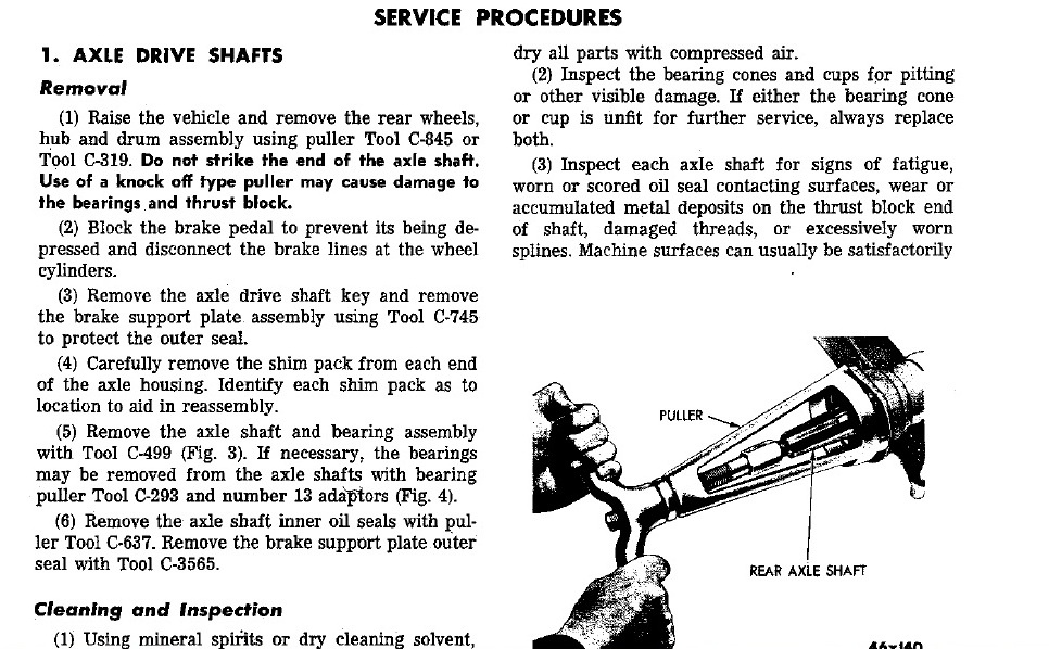

After finally slowing down at work amd getting a chance to get back at it the axle shafts are still stuck. I dont know alot about 8 3/4 so bear with me. All thats left is the spindle. I can see the bearing. Ive tried putting the axle nut back on amd using the wheel and drum as slide hammer. Nothing. I made a slide hammer at work. Nothing. Do you have to remove anytning in the pumpkin to pull them out or do i just have a stuck one. Ill put some picks up later. Thanks
All I can say is this is from a '63 Chrysler manual.
I once had a stuck axle shaft (Ford 9" but same deal) and made up a ten pound slide hammer. I wailed away with it forever, no results. I went back to work and made a seventy pound sliding weight. The axle came out with the second pull...
