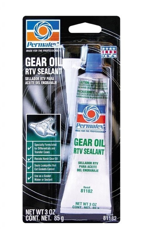

I tried an expensive reusable rubber gasket with no RTV, OEM paper gasket with RTV and still had leaks. My leak was via the studs where they come through the flange; they are knurled and press fit into the flange.
I took Doctor Diff's advice and used Permatex Gear Oil RTV with no leaks:
Makes you wonder why dr diff sells the gaskets.
I've never seen that product. Still learning all these years later.

I just used a paper gasket, so far my leak is too slow for me to care about. Maybe one drip a week or so. Whenever I need to remove it I'll be using that gear gasket goo. As far as leaks go anyway the rear end is the least of my problems. Transmission leaks way more.
