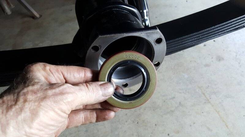

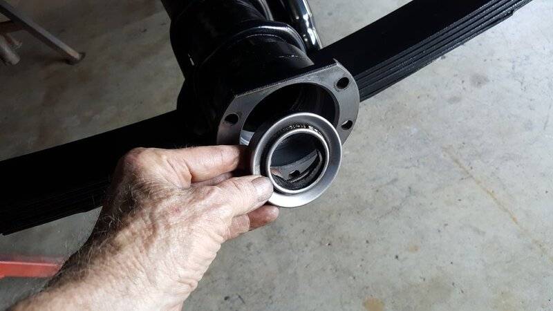

Cass sent me inner seals along with the flanged axle replacements. With everything needed to complete the conversion IIRC I had around $400 total into it. (Post #224 in the link below)
I would just replace the bearings/races and seals if I were the OP.
Old seal...
New style seal...

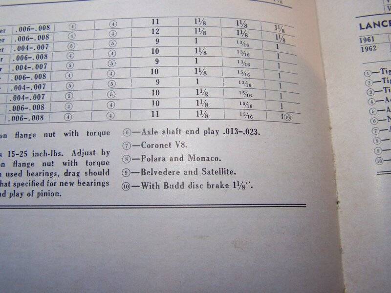

The end play for the key axle is .006 What year is for car. Remove all end play first and put .006 on the right.
Sorry for all the photo my hand are cool it maybe +4 today
