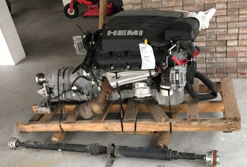

View attachment 624416 HELP! I have this great 5.7 HEMI and it’s matching 8 speed transmission that came from a wrecked 2016 challenger RT and I want to put it on my Superbird Tribute...
has ANYONE ever put an 8 speed in a b body? If so, I’d like to find out how you did it please..
I think you shoul call street and performance in AZ the guy is very friendly and easy to go with he sell the wire harness for the modern hemi swap as long as the A8 trans I agree with Greg is a no go.

I’m abandoning the 8 speed... just too much for a backyard mechanic..also all experts say unanimously it won’t wrk.....
I’m going with an automatic transmission that has been built to accommodate the new motors hp....
I think it’s a 904, I’m trading my 440/727 for cash and the transmission from a friend...
Frankly, I want it on the road, and may go back later on with the 8 speed once someone figures out how..

Keep it simple, 904 or 727 w/ GV. No reason to even attempt to get an 8HP70 transmission to work.
Mopar dropped the ball, they should have had retro-fit kits for 8HP70/8HP90 transmissions immediately along with their plug-and-play kit for the 5.7/6.4 HEMI. Just seems like common sense to me.

Read a thread on Moparts where a guy is working with Russell Drake at Soundgermanautomotive.com on the 8 speed swap solution. This is the guy who beat the Nag1 swap by building a stand alone computer . I have his piece in my GTX and it is awesome. He says he has the programming solved for the 8 speed now.

That would be a game changer if the 8HP70 was a stand-alone upgrade for our platform.
