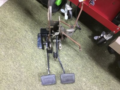

I’m sorry guys I gave up and bought a six speed manual.....
I hate to hear that the 8 speed didn't work out, But I bet the 6 speed will be a lot easier.
There is still some tunnel work to do, and I’ve already modified the pedals which was easier then expected.. last, there’s nothing like SHIFTING THROUGH THE GEARS AND ACTUALLY DRIVING THE WHEELS OFF THE CAR.... instead of just putting the right foot down...
