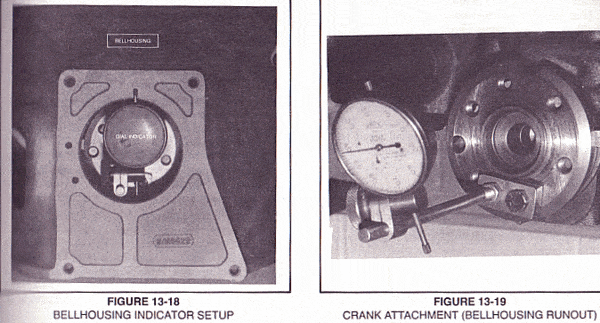

I firmly believe in checking your bellhousing run out with a dial indicator. I needed to instal an offset bushing kit. Otherwise you could have a tranny that does not shift good or jumps out of gear.............................MO

1/8" sounds excessive to me. I think the indicator on the crank flange will tell you where to go with the bell and dowels. Don't know I'd trust a mic.

Thanks Dave, and all others, going to get a dial ,and try to figure this out, maybe 1/8" is not that accurate on my part, could be 1/16 hard to say till I get proper tool,
