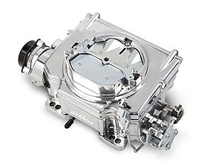

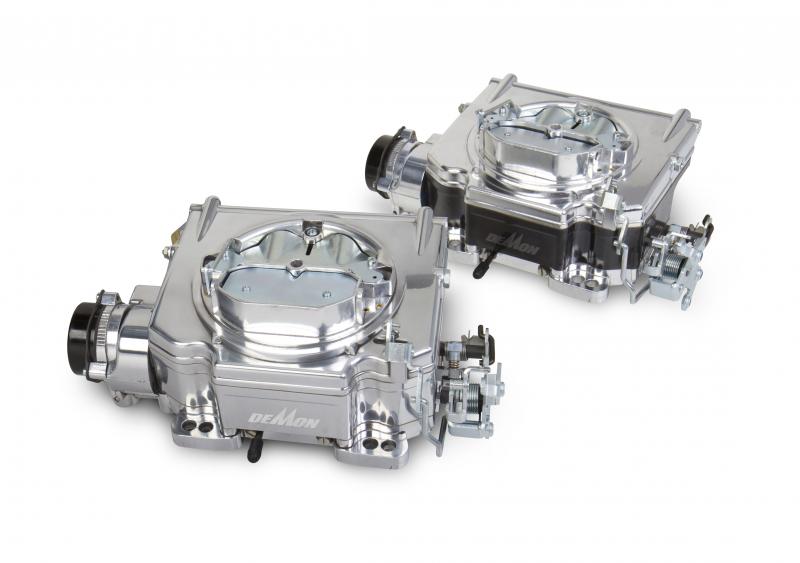

carb you could try the "newer" Street Demon 625cfm {spread-bore} as an alternative to the Edelbrock also

  • Demon 'Street Demon' 625cfm Spread Bore Polished Vac. Sec. Elect. Choke 4bbl #333-1902 #1.jpg
