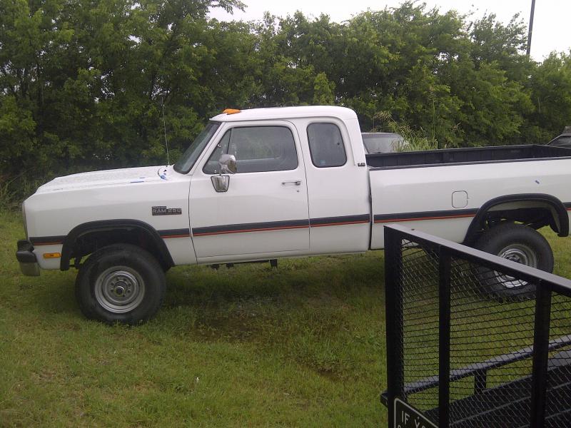

Just in case anyone's wondering what this Ram W250 Diesel looks like? Taken today. Almost done.

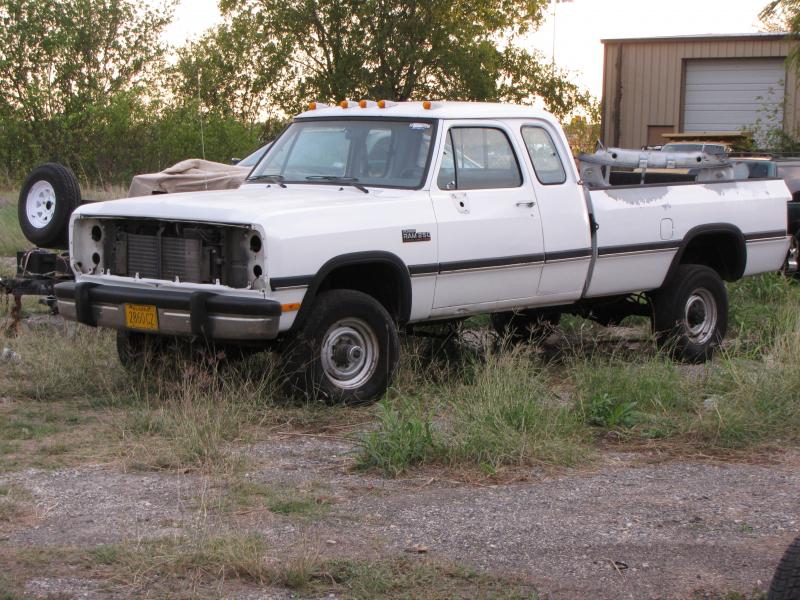

What it used to look like...
Some subtle yet effective modifications: Gen IV roof clearance lights installed, notice the cool Cummins Orange color on bottom of body mouldings? Same color as the original fender badging color! It really stands out that black and orange and white, really sharp looking IMHO, and I'm my own worst critic! This mod was actually needed as the original was chrome, and it was crapped out, and this moulding is no longer available, and, what pieces are still out there in the system are wicked expensive (I had to change one piece that I broke), so, sanded the old chrome parts off, smoothed the plastic, primed, single stage orange, about 20 coats, then sanded it down giving it that correct Orange color.
