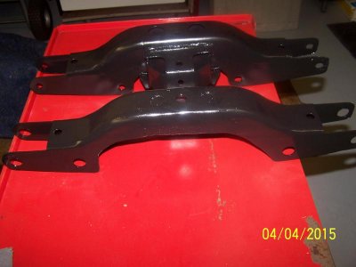

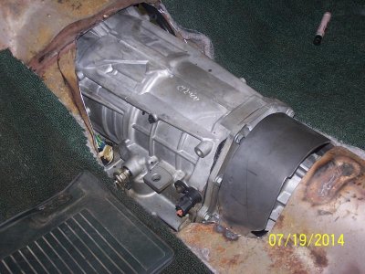

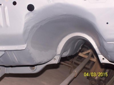

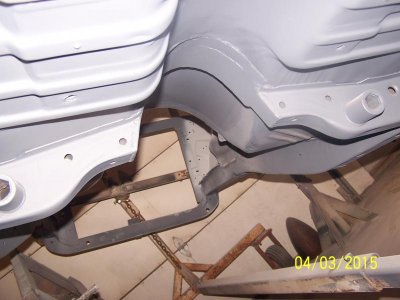

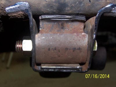

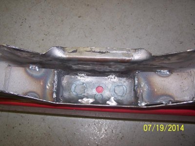

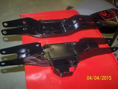

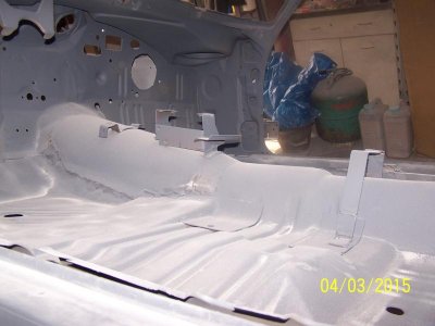

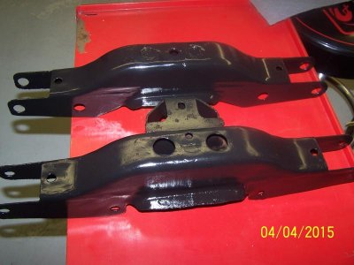

Here are some pics of what I did with my tunnel. As you can see, it was a bit more than a couple whacks with a ball pean hammer. A good tin bender would have made it look nicer but it will be covered up for the most part. The 1st pic shows what I cut out of the TB cross member. 2nd pic shows the stiffener added back in for the relocated cross member bolt.
I don't have any measurements but you can see my tunnel is raised up 1 1/2" and my console will be 1 1/2" higher because of it. I wanted the tunnel up to make room for the shift cable to be able to fit above the transmission. I don't have all the t's crossed or i's dotted but it is starting to come around. The last few pics show what I did with the Transmission cross member. I put in a unmolested cross member to show the surgery I did to make it work. Hope it helps. I can get some measurements of whatever you would like. On another note, I have the 6.1 exhaust manifolds that will fit your 5.7 if you want to cut them up to try to make them work. I won't be needing them.

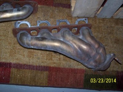

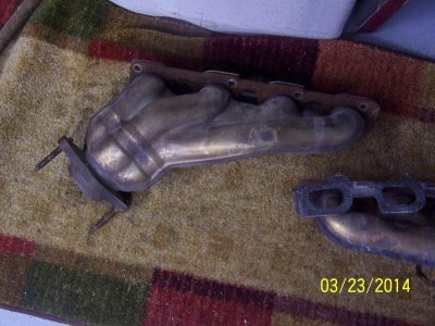

Here are a couple pics of the exhaust manifolds. My engine came out of an 06 Charger SRT8 so that is what these manifolds are. The ends would need to be cut off and turned down to enable them to work on a B body. As they are, they are aimed at the firewall and would be almost impossible to install a head pipe to them. I didn't want the headache so went with TTI's headers. 100_6186.jpg100_6187.jpg

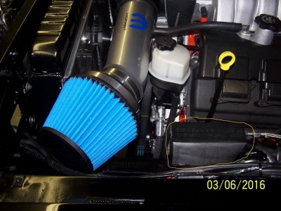

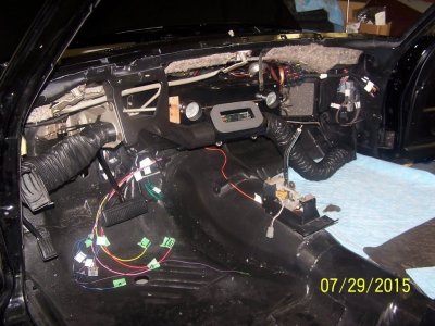

My 68 Charger has the A/C heater box. Way too big under the dash for the fly by wire gas pedal. No room between the heater box and steering column. My fix was to use the stock gas pedal and use the bell crank assembly from an 2004 Ram truck. Here are a couple pics showing the under dash area and the bell crank circled in yellow in the under hood pic. If you don't have air, you should have room for the fly by wire pedal. They are kinda ugly in my opinion but you will have to decide which way to go.
