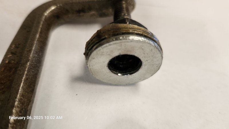

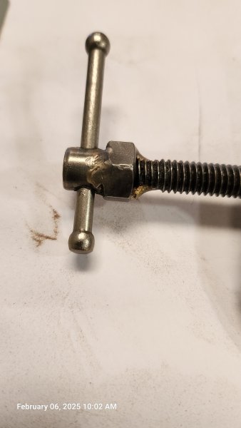

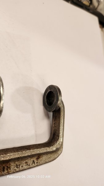

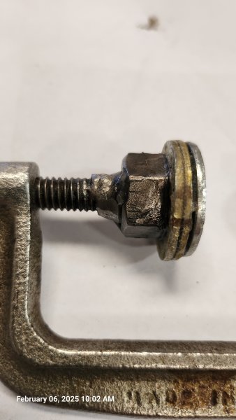

I wish I had found this when I started working on my quarter window. It took many steps to arrive at the clamp pictured. 1st step after failure was to weld up the swivel on the clamp, 2nd was the positioning washer on the other end ( fits over the back of the stud in the arm and really helped with lining up the clamp) 3rd was to shorten the screw on the clamp so it would fit between the mechanism and the body. After many tries and fails and bruises and cuts, I super glued the washers on the welded swivel and got the clip on in 1 minute.
