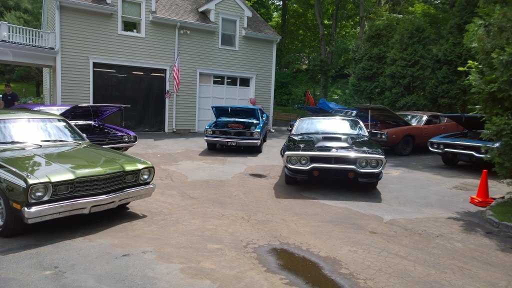

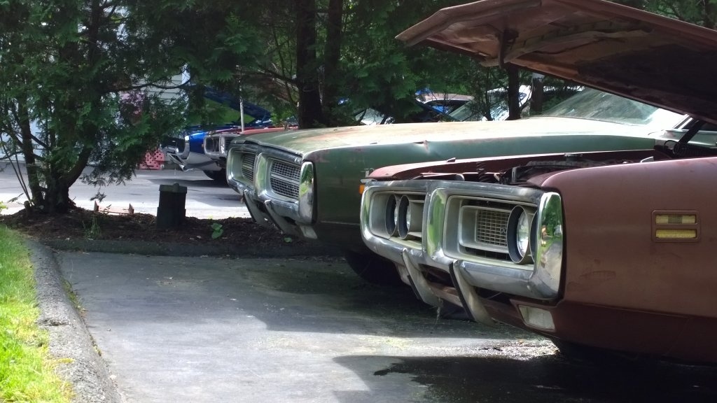

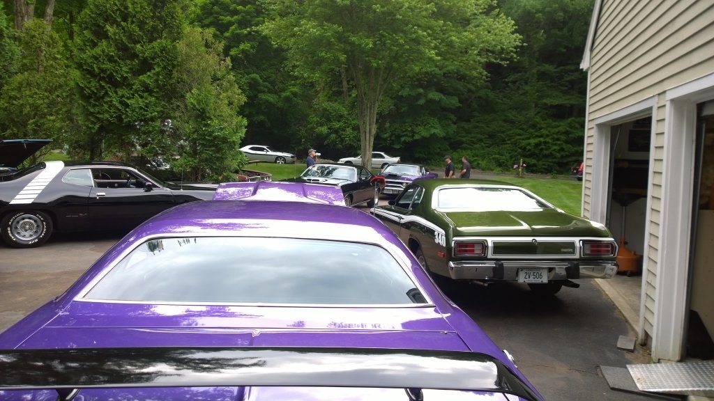

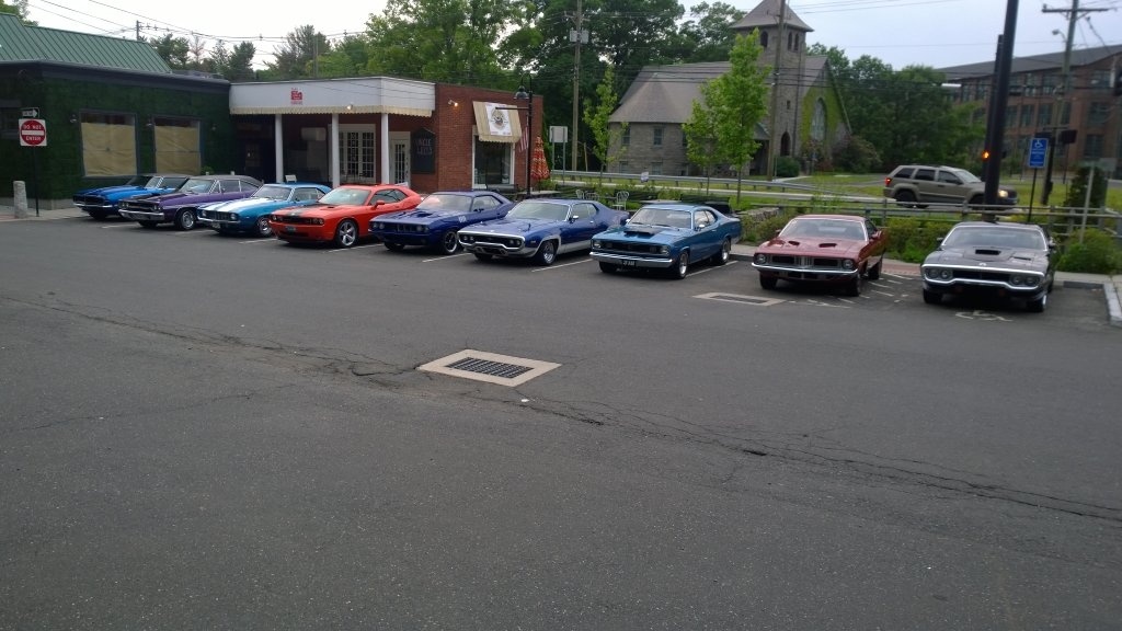

Yesterday was a good day. I went to a Mopar focused birthday party and then we all cruised to a bar. I watched over the cars while the adults partied. My pay was getting to drive the black 1971/1972 Roadrunner GTX in the pictures I'll post below. The car has the side markers of a 71 but the rear bumper of a 72. Its a curious car. I loved the experience though.
Its a completely different machine from mine. The whole car is essentially stock save a repaint. The pedal feel and kickdown was totally different from my car. I like it because it all worked perfectly. The car handled like a dream too because of the front and rear sway bars. Those are now bumped way up on the list of things to do.
I squeaked the tires accidentally off a stop sign with just a little bit too much throttle. With my car I have to be on the brakes to do that.... My best guess is that the torque curve on a stock motor is a little different. That combined with a properly tuned carb probably has the biggest effect since both cars have 727s and 3.23s.
If anyone has any questions about options or any of these cars, I can talk about most of them so ask away.
