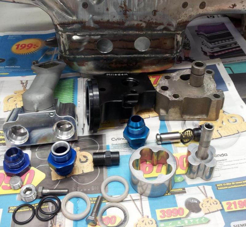

Update. Low oilpressure. Okey on idle and up to 4000rpm and only 3.2bar at 5000rpm. 15/40 syntetic. Melling hv but still 3/8 tub. testing some ideas tomorrow. .
Update. Checked all things and the only thing i think is left is the 3/8 tube so went ahead and made the hole for 1/2 thread. So good so far but i cant get the new pickup in because the long main bolts and the girdle so i am left with external oil pickup. Got a pump from a friend who moved on to this:
http://www.teamrt.se/?page_id=34 . Yes this is a Allan johnson car now living in sweden.
Will get back with pictures.
Hi again.

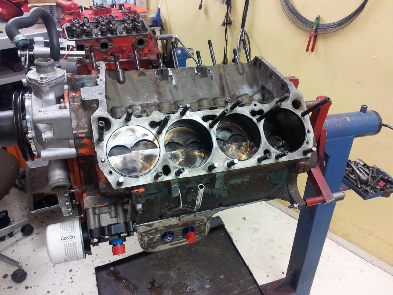

The engine is being put together again. Some new parts will hopfully the fix the pressure.

Johan, looks good! Your white oil filter looks smallish...I think the bigger ones with bigger filter area are better?

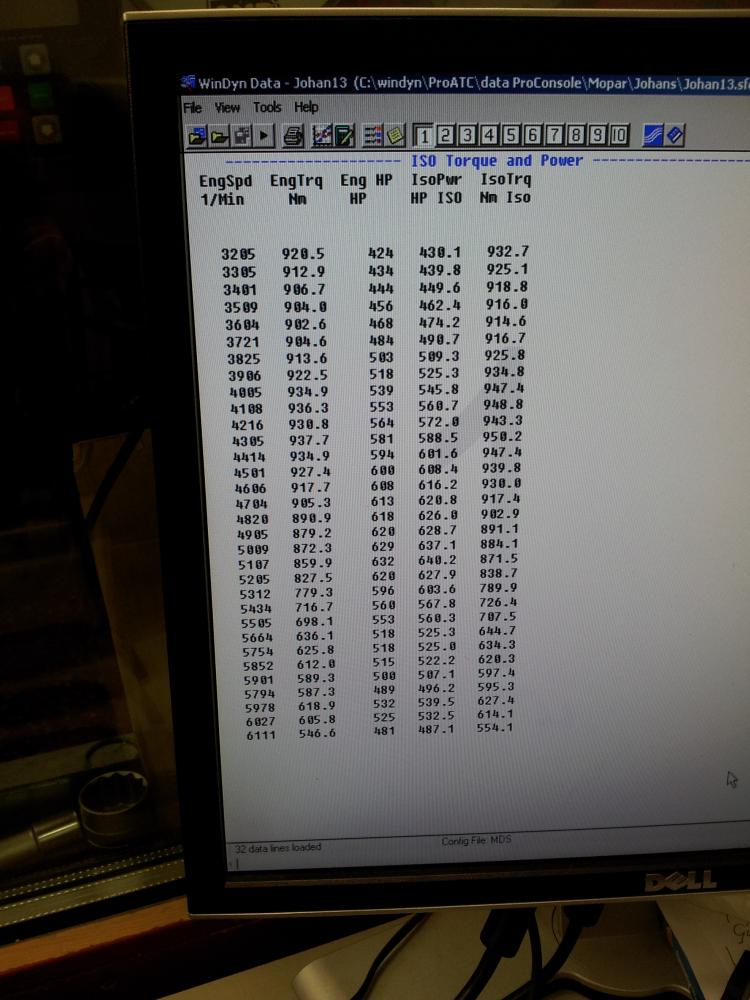

finaly it went in the superflow for some testing. Change the ecu to KMS but the rest is the same.

Me and my friend bought new milodon pumps. I already had the cover for external and he is using intenal 3/8 tube.
Made the oilpressure to were we want it so now it is OK. Found some problems with the pump. The bottom were the rotor rests does not seem to align with the Surface that are for the blockmounting. Look at youtube for coronet69swede. have put some clips there and se.
