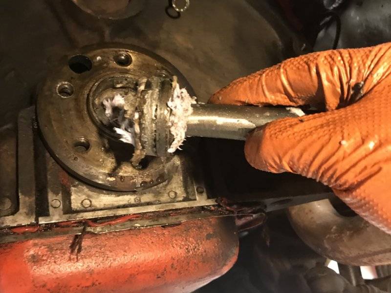

A833 Input Shaft
Eberg has a tool to get that out, but you could use a grade 5 bolt the will bite into the bushing some, drill a hole in it, put a zerk on the hex side, pump grease into it and it’ll pop right out.
Similar solution: Pack recess with wheel bearing grease. Use a dowel (wood works, old input shaft, etc.) or other item that fits into the pilot hole and whack it with a small sledge. It will hydraulic the bushing out in short order. Good luck.

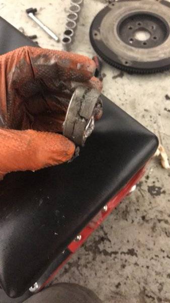

Gonna try it with paper, bread didn’t work and it’s worth a shot before I weld a big bolt on there and make a tool to pull it
Bread is out, paper is in
