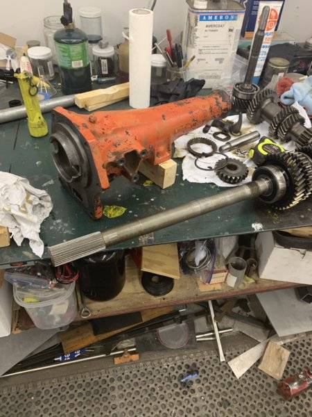

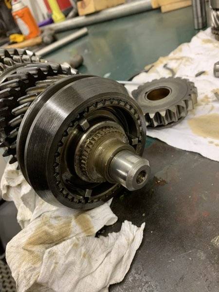

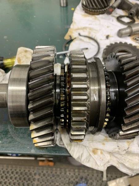

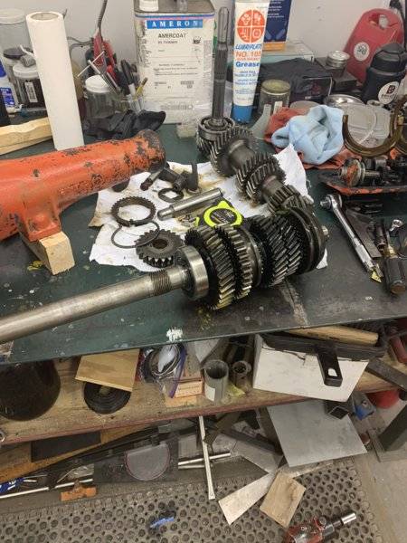

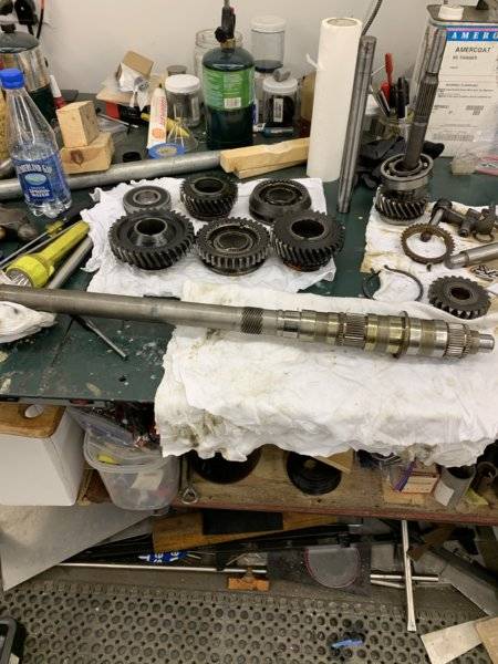

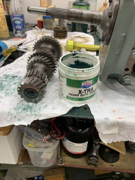

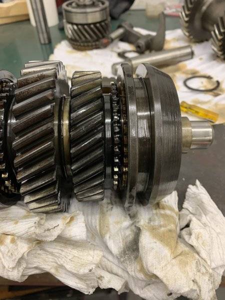

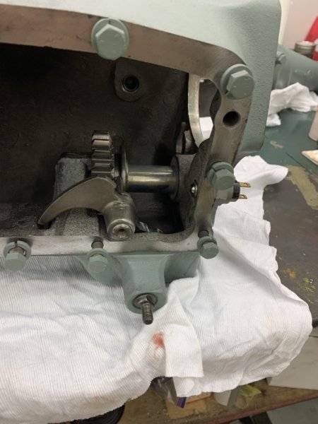

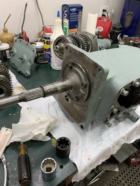

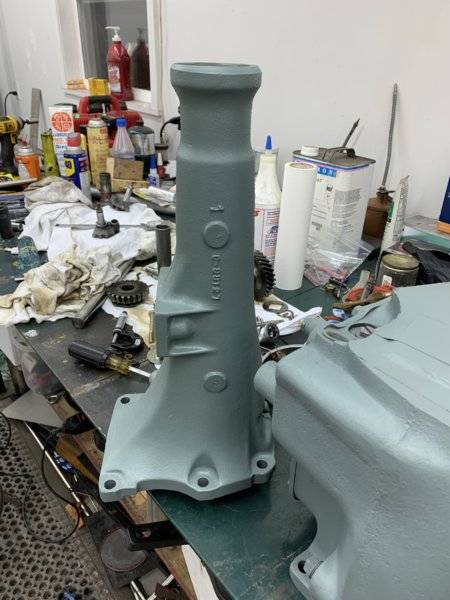

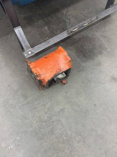

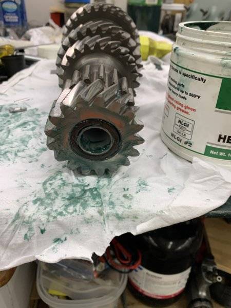

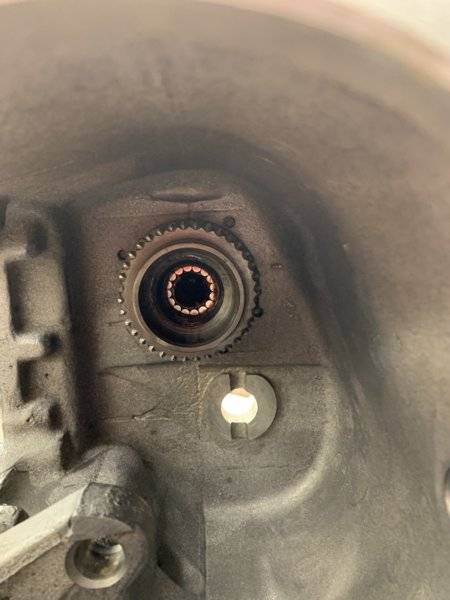

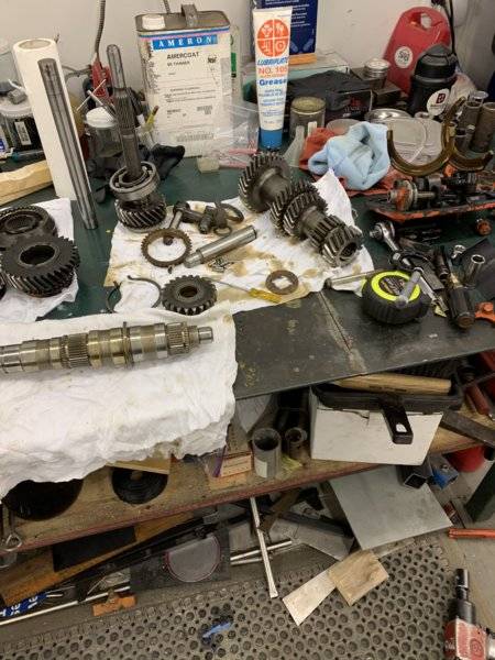

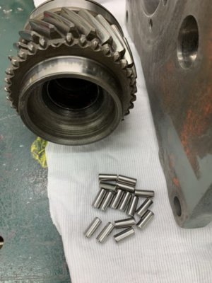

Have my gearbox torn down for rebuild so far it’s been a straight forward process. It needs bearings for sure and the synchros looked good but will replace them while I’m here as well
as the needle bearings for the counter gear. Got all the parts from Passon and Brewers both
have been great folks to deal with. Toughest part of the whole process so far was getting the housings clean inside. Here’s some pics of the whole mess:lol:

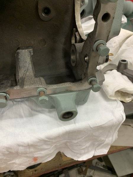

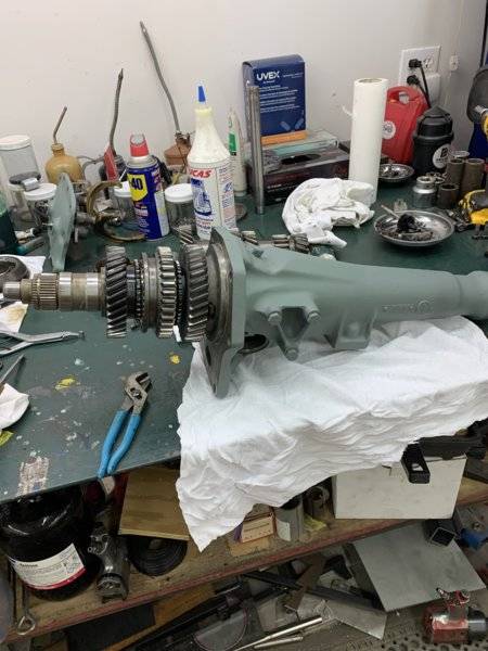

I sandblasted the housing and etched primed them gonna paint Eastwood
spray gray 2k urethane once I get it all assembled.

It was doing fine had a leak at the reverse shaft
so once I tore it down that far may as well check bearings and synchros. Synchros looked good but

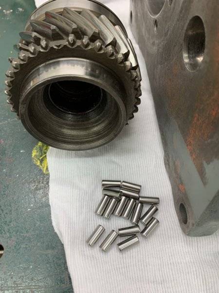

Im on the side of while I’m there replace them.
Once I removed ,cleaned and dried the bearings they were rough and noisy so time to replace them.
Cost was around 250 for gaskets and parts I replaced the counter shaft and needle bearings
both main bearings and synchros. The case and tail housing was full of metal so glad I got all of it cleaned out and I mean every crook and crevice!
Also disassembled the clutches and cleaned every part in there. Got a 493 stroker in the works to put it behind so it needed to be in tip top shape.
View attachment 883380 View attachment 883381 View attachment 883382 View attachment 883383 View attachment 883384 View attachment 883385 View attachment 883386 View attachment 883387 View attachment 883388 View attachment 883389

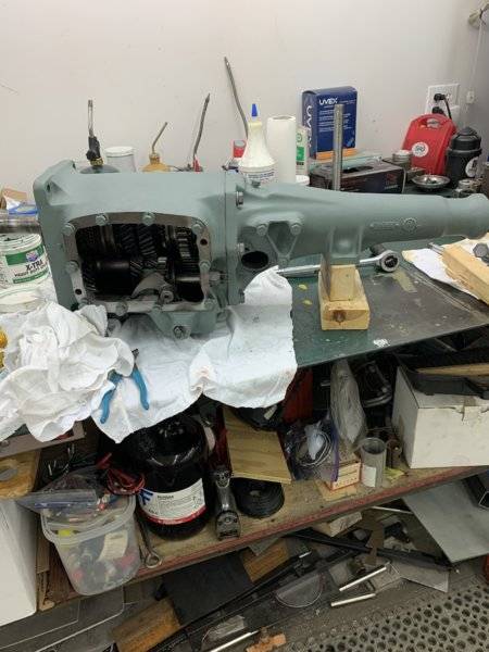

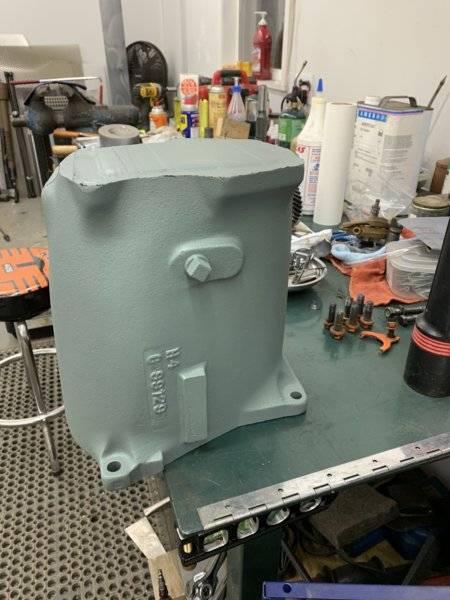

I am about to paint my A833 transmission for my '69 RR and wanted to confirm if the 'plate' that the shifter arms goes thru is painted a different color?
They were left bare cast from the factory. All depends what you want, painted mine "twinkle dinkle" so it doesn't rust.
Thank you so much for such a timely response !!!!!!! Now that you've replied I'm going to paint mine cast (medium grey) including the inspection cover.
