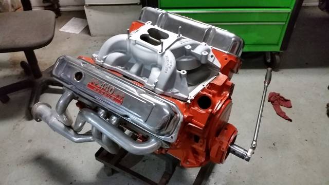

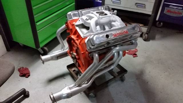

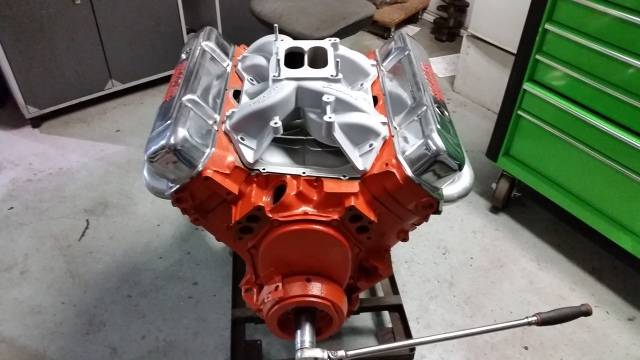

The 440 is built and ready to go in. Thank goodness. There's been enough delays already and I will be quite happy to see that thing stuffed under the hood once and for all.
It has the 906's and they've been ported, polished, and slightly milled down. They did a 3 angle valve job, new guides, everything, it was all gone through. It's got a full roller cam and lifter set up. I'm hoping those headers will work. We got good deals on all this stuff. Edelbrock intake. Probably going with an Edelbrock carb. I had him build it to run off pump gas. It's not going to be a drag racer but it's going to have plenty of power. It'll be a ton better than the little anemic 318 it was born with, haha

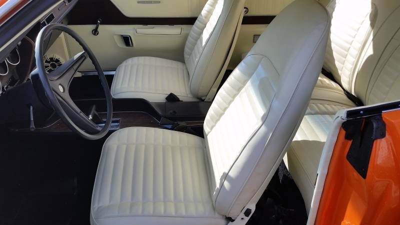

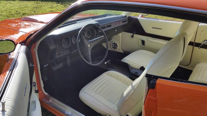

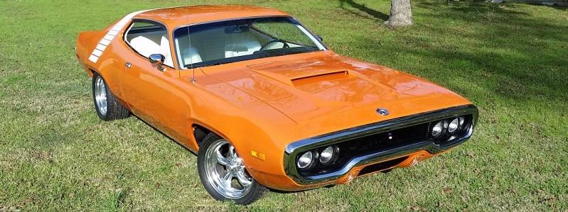

Well, I am just about finished with the interior. A little touch up here and there. A couple missing screws but all in all it's in and done. I think it turned out quite cool looking.
The way I did those front speakers in the kick panels really made that look a lot better and they blend in a bit better than if I'd had just left the grill black.
Magnes are the front door armrests aftermarket? I see the color difference a little but how is the grain.
My left one was bad but I bought a Black NOS one I plan to dye with the rest of the stuff.
The color match looks right on with the uppers, were the uppers dyed too or new Legendary.

Nope, they are original and they do actually match when you see them in person. I went over everything with the SEM "dye". I'm guessing it looks like a different shade in those pics because of the lighting and the different angle from the surrounding pieces. I dunno. They do look right in person though.
The uppers are original to the car but yes, I did re-dye them back to white in order to make sure everything matches.
Many of the original hard plastic pieces for this car were really chalky since they were white originally. So I had to swap out almost every hard plastic piece in the car and use green pieces from my parts car or left over black pieces from my last car and dye them white as well.
I used all the different SEM prep stuff before shooting the dye. It was a bit of a chore. Just when you think you have it all done, you remember another piece that will need to be shot.

No disrespect taken Ron. The lighting was bad and in the pic it DOES look like they don't match. I will shoot better pics when the whole car is finished.
