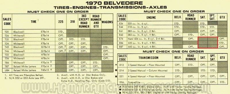

Cropped image lifted from Hamtramck Historical; 383 was largest you could "specify" in a Sat or Sport Sat; shaded boxes = "not available"

The black square next to the four speed line tells us you could not get a four speed behind a /6, 318 or a 383-2bbl.
The triangle tells us you could only get a three speed floor shift behind a 383-4bbl.
