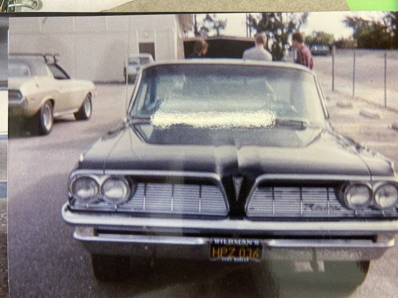

I had no problems with the 70. The stands pinch down on the gutter in the gap between the trim and roof. There is a J looking piece, vinyl coated, that comes around the outside and another vinyl coated one that fits between the trim and roof. There is a tension adjustment on it so it all pulls together. Didn't affect anything on the car. I was using a Yakima unit. The tension unit had lock cylinders too for some security. Once you get the basic unit on there with the crossbars, you can accessorize it with racks, storage units[ looks like an aero coffin], baskets etc. You could even DIY something with wood. Since the car will not most likely be listed, make a measurement of the width between the gutters and how tall the stands would need to be so you don't rub/damage the roof. From there you should be good. Check out an REI or bicycle outfit in the area. Also you could contact one of the companies direct for fit info and which one to get.
I managed to find an old photo of my 70 with the rack on. Unfortunately, not a close up.
