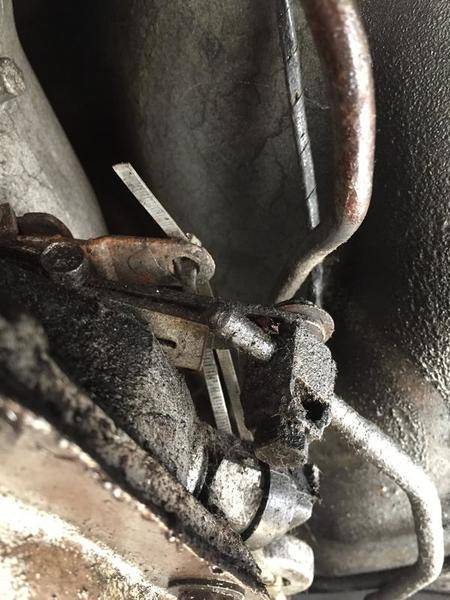

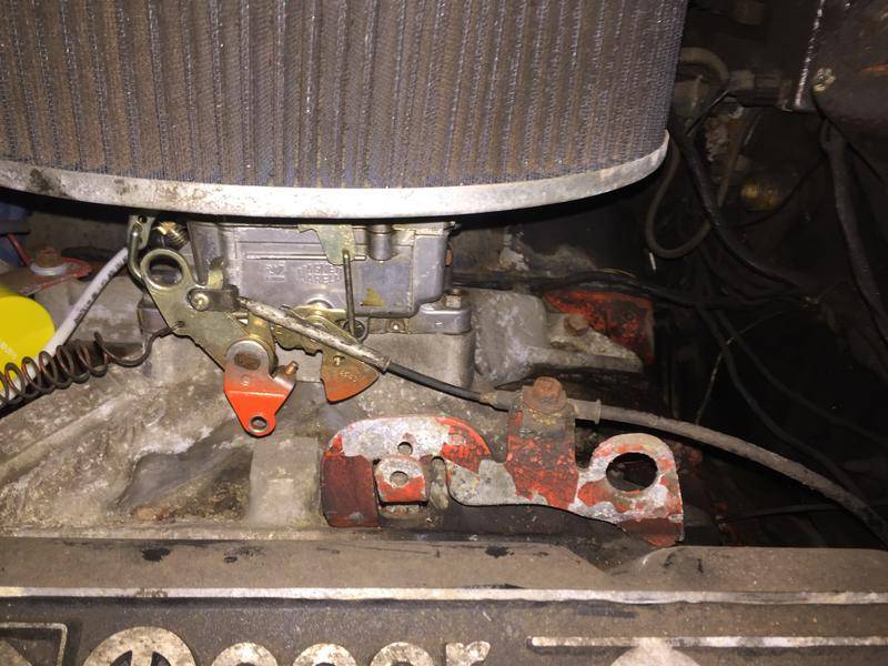

There it is. I see no loose cables or anything hanging out where there shouldn't be. Weird
Maybe a 2 bbl short bracket on a tall alum intake? Get some kickdown linkage, and a lever adapter for Mopar throttle also. Something is up w your trans; usually no linkage means short shifting. Either way is bad.

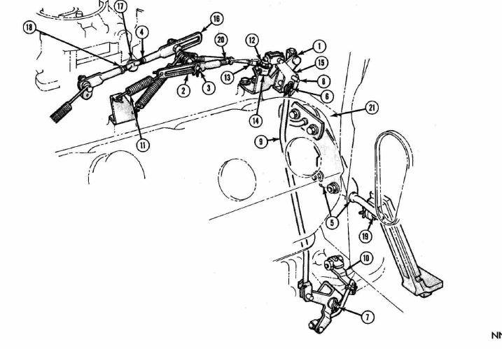

This isn't a picture of what your is but its the same idea. number 10 controls trans pressure . That 10 should be all the way back at full throttle.

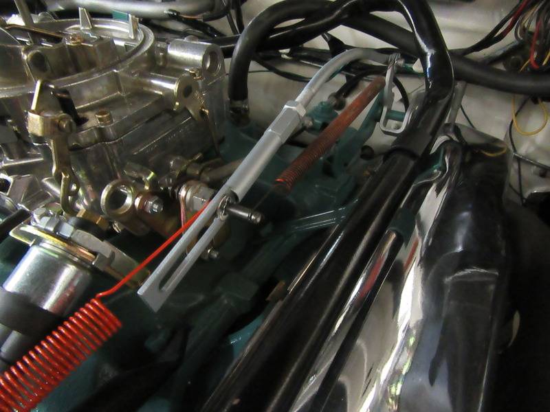

This is an Edelbrock carb but you should have something that looks similar to this.
This is an edelbrock carb but you should have something that looks similar to this - at least for the stock mechanical type linkage.
Get underneath and look at the driver side of the transmission. There's a lever for the gearshift selector and the kickdown lever is on top of it. See if it's tied back (or even on there!) That's where you've gotta get the kickdown linkage or cable to.
