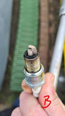

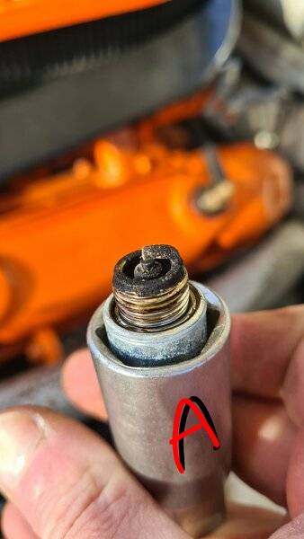

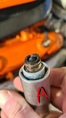

Hi all, I would like some advice on spark plugs. A is from a 440 6 pack, is that too rich?
And B is from a 318 4 barrel, is that too lean?
Thank you a lot.

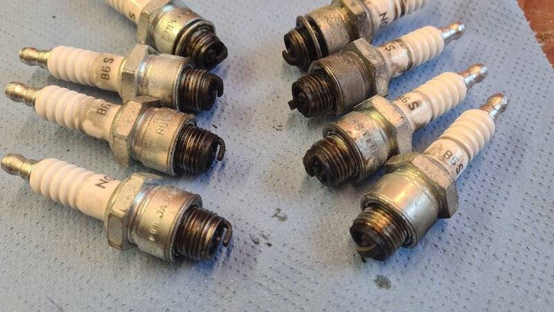

A ones are NGK B6S (being replaced for AC Delco R43S)
B are Champion RN14YC (being replaced for Champion 3405)
No idea about mileage, got the car with them and just checking it now.
I think you should replace them and then check the new plugs after driving. Then you will have an idea of how the engines perform. I imagine the engines were started multiple times without warming up which will lead to extra deposits on the plugs.

Personally, i would use AC/DELCO R44S as its one step hotter.....or consider Champion RJ-12YC or Autolite AP85. The origional NGKs shown as just a little too cold. Origional plugs were Mopar P34P equal to Champion J11Y. The current venue of plugs have a copper component in their center electrode which results in a broader heat range. But mixture, spark advance characteristics, cam shaft and compression ratio all influence the spark plug coloration. Just my opinion of course.

Don't know why you had the the B6S plugs in the 440, not even recommended for a stock 6bbl or any 440. The stock plug would be a GR4 or a BPR4ES. Without any info on compression, cam, ignition, exhaust, it's hard to say what would work, I use NGK R5670-6 with my setup with very good results.

Both look like there is alot of miles on them.
Usually want to check the plugs after some highway driving or a hard pass down the track.
If the engine was idling and low speed stop and go driving, it makes reading the plugs really hard unless you know more about the tune up.
"A" is so rich and carboned up. I think the air/fuel ratio needs to be fixed (leaned out). The plug heat range is harder to see on the threads of the short threaded plugs, Might need a hotter plug, but hard to tell until the air/fuel mixture is fixed. A hotter plug would help burn some of the carbon off if the engine is still running rich (or burning some oil?)
"B" looks pretty decent heat range and timing wise. The carbon around the ring could be mileage or just too much slow driving before pulling the plugs?

The 318 was originally 2bbl, someone installed a holley 4bbl at some point probably many many years ago. Engine 73.
1973 318 used a Champion RN14YC or NGK GR4. The 340 used the same plug, so it seems the 4bbl doesn't change anything.

A there is nothing to read except it has been in there a long time.
B, is actually pretty good. Heat band on the ground strap is in the bend so it is good, has plenty of miles and could probably pick up a little with a primary side jet increase.
