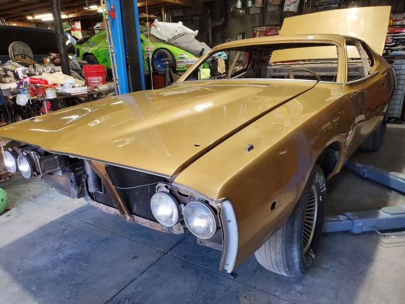

Hi all! I'm putting my Charger back together, and I don't know if it would be easier to install the carpet or dash first! Does it matter? Any tips on things to watch out for? Thank you!
Carpet... Nice Charger! You gonna put the black cutout on the bulge?:drinks:
