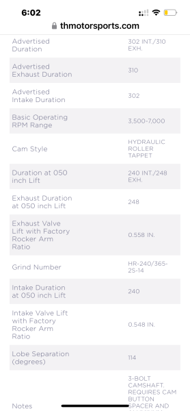

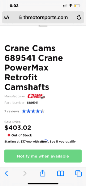

Voodoo retro fit hydraulic roller
#20230711Lun
Duration (Int/Exh) 270/278
Gross valve lift (In/Exh) 513/530
Range 1800-5800
I’m looking at a Hughes 2000 stall.
#20230711Lun
Range 1800-5800

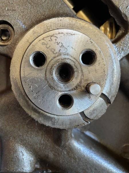

Current build(not sure of cam specs) engine kills and won’t stay running when put in drive with the stock converter. I would keep it as is if I don’t have to go over 2500-3000 stall.
The cam I listed above would be my alternative if I can’t make the engine behave as is with a 2500-3000 stall.
So if I change to a milder cam(listed above) I’m trying to figure out the best converter.

I’m so confused. So the cam that you listed is not purchased or in the car. Correct?
Do you want a TC recommendation for the cam you don’t have but you posted?, Or for the cam that you don’t know what it is?
If it’s the latter, we cannot make any sensible recommendation. Furthermore, W/o cam specs, we cannot truly understand if your problem is a cam size issue verses some other issue.
Those specs are for the current cam in the car. It would require a minimum 3500 stall converter. Not ideal for what I want.
So what I seek now is a good cam for the 505 with a 2000 stall and 3:23 gears.
