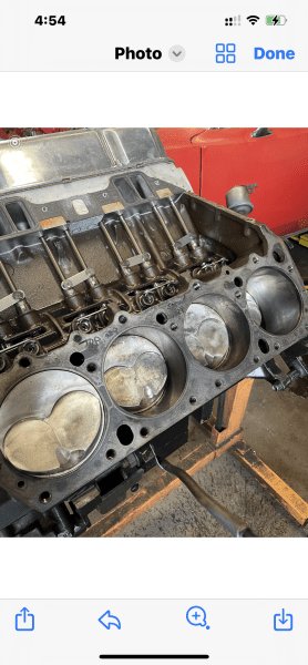

Okay so we started tearing the engine down. Shame on me for trying to go the quick easy route. Took the driver’s side head off to measure bore and determine how high in the hole we were at TDC. This engine had been sitting since built for a few years. The owner would turn it over by hand once a week while it sat in his shop.

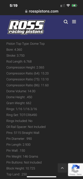

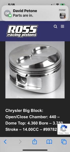

So far, we’ve determined the bore to be 4.360 and the piston stamping confirms. These are Ross domed pistons part #99782. Upon inspecting the heads and valves, we noticed hole 5(driver side 1,3,5,7) had a cracked exhaust valve. We haven’t removed the other head yet as it doesn’t matter at this point. I am gutted and discouraged.

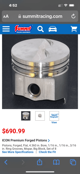

So now I’ll seek out some Flat top pistons with the same profile(specs), do a light cylinder hone, and reassemble.

Pics for comments and / or advice.

As it is and a page from Ross showing specs of current pistons.
And what I am looking at as a replacement set:

Intake valve.
Remove the valve and inspect it. Looks more like a scratch than a crack in the pic.
What’s wrong with the pistons?
Intake valve.
If you blow up the Picture you can see the defect.
These are the pics my mechanic sent so I have not seen them in person.
As for the pistons, I am trying tp get the compression down to a manageable compression. Not sure what the compression is as of now. as you can see, the piston at TDC is pretty much all the way to the top of the cylinder the head gasket is .051.. Not sure a head gasket change will get me to 11:1 or lower but then again, I know nothing of this. I would love to be able to use as built but I am not sure it will be what I need it to be.
If I had to guess (and it's just a guess) I would say the compression is at least 12:1
