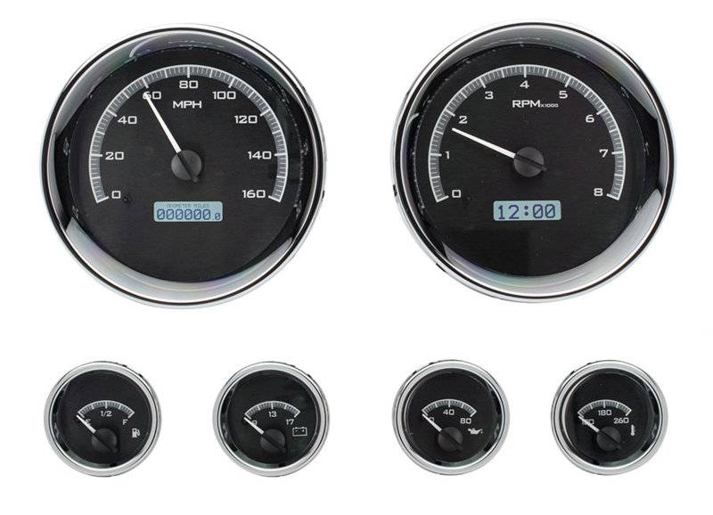

Hi Craig,
I had Dakota digital make me a custom dash using a core for my 69 RR but for my tri-guage cluster I used Speedhut and am really impressed with them. Fully customizable when you order with lots of options and they are a nice quality guage.

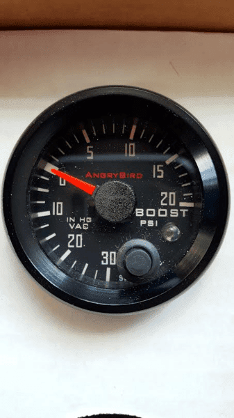

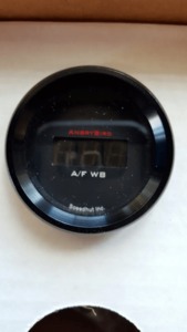

I used them and while they haven't been operational yet I like the look and the quality. Only issue I had was the speedo showing up with "Satelite" instead of "Satellite" printed on it. But I sent it back in and they immediately corrected the problem.

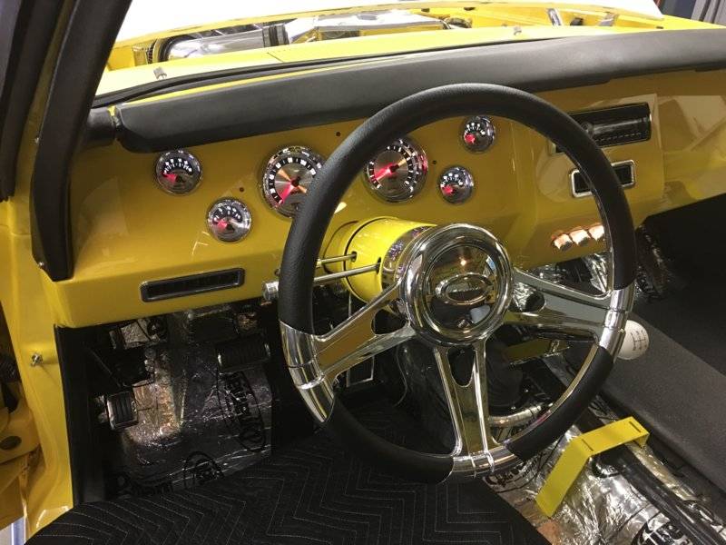

Really nice looking gauges and dash, great job in matching that up! I wish I had that big window Chevy truck in my garage, like in your previous pictures....a 55 or 56? Trade you straight up for a 5 year old Subaru outback that runs like a top!

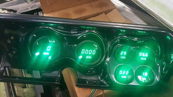

I am waiting for my Intellitronix kit to show up this week. Going with build a dash kit with the green LED,s like yours. Have to build a custom bezel using MDF and my old long sweep unit. I will then wrap it in fiberglass and carbon fiber. Curious why you didnt just use the bright and turn indicators built into the speedo unit?

Ok. I got you. My kit is supposed to be in this week so I will start working on it this weekend. Need to get it built so I can finish wiring my car. I went with the green because they had them 25% off for St Paddy's. I was a little worried because I could not find any green ones but seeing yours I like really like it with the carbon fiber. I will definitely post pics when I'm done.

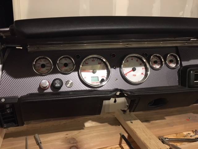

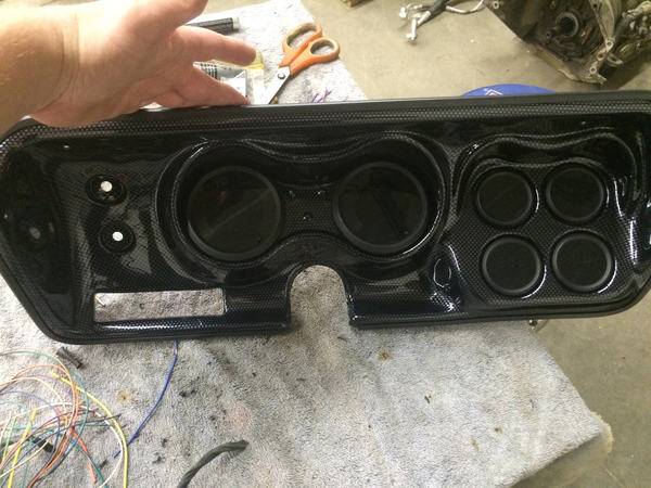

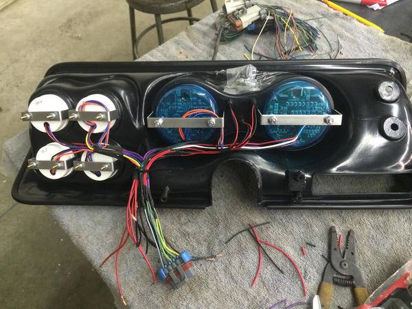

Built a new dash panel with carbon fiber and Speed Hut gauges for my 69 Coronet. Sorry about the lighting for the pictures
but will be installing soon.
