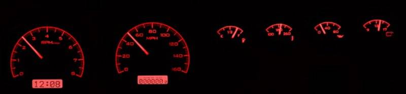

I got a deal from a local authorized dealer on this Dakota digital 70 Roadrunner dash
with red backlighting (best for night vision)
and is compatible with the A/F ratio module and the Innovative Motorsports A/F system with this Dakota digital module
I may use the A/F add on if it shows BOTH left and right O2 sensors simultaneously, otherwise I'll just use the Innovative Motorsports dual bank gauge.

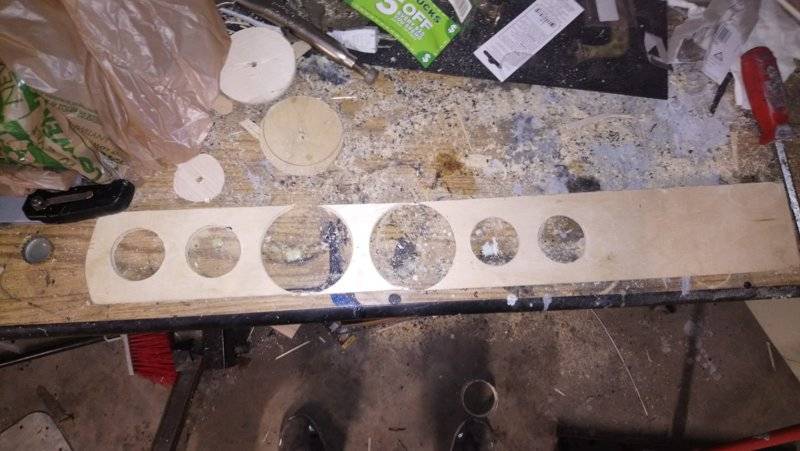

I am waiting for my Intellitronix kit to show up this week. Going with build a dash kit with the green LED,s like yours. Have to build a custom bezel using MDF and my old long sweep unit. I will then wrap it in fiberglass and carbon fiber. Curious why you didnt just use the bright and turn indicators built into the speedo unit?

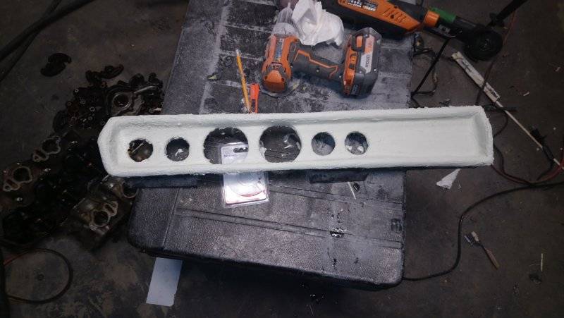

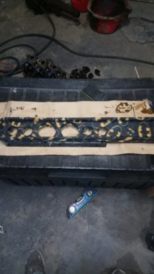

Some photos of the Coronet cluster conversion in progress. Cut out the original sweep and used basswood from hobby store to make new bezel. Then wrapped in fleece and epoxy. Just finished sanding and laying down filler. Will sand and wrap in carbon fiber cloth then install imtellitronix build a gauge kit on bottom side.

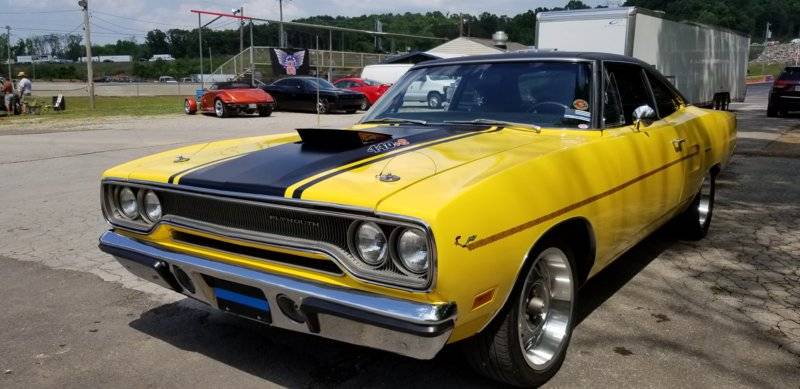

I like your build .I had a 69 road runner and it was a numbers matching car including engine until you looked inside lol ran great kept everything bone stock looking but man did it go .I would like to see your finished product I am a road runner man .

If you're referring to me, my car is a REAL V-code 70 Roadrunner, but the engine is a "heavy rods" 1971 440.
There are a couple of brothers who are in my car club and friends of mine who went the "factory correct" route, although one has a 426 Hemi which is not the correct motor for the car. After seeing what they do and spend to go that route, and "competing" in shows with them, always knowing I would place lower than their cars, and loving to take my car to the racetrack, I am going more "boulevard bruiser" with my build, and instead of getting the "correct" hardware, I am just making sure the nuts, bolts, etc are top quality and as strong or nice looking as possible.

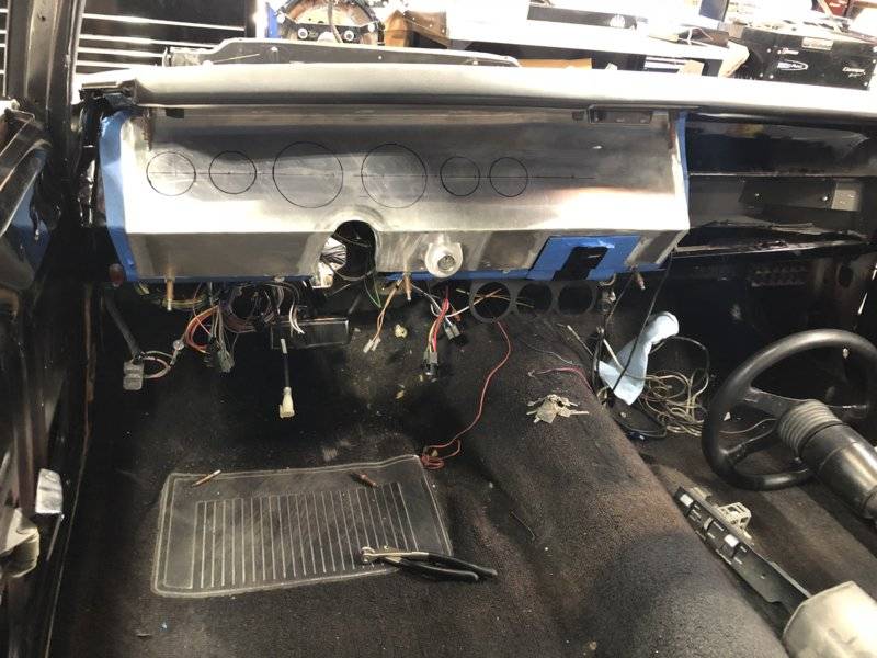

So many choices. I used AM carbon fiber gauges and wanting to use the stock dash without the stock crinklelook I used a SE charger woodgrain cover and merely sanded the woodgrain off in prep for a carbon fiber overlay on my 70 Pro Touring Bird. Super easy and haven't seen it done before.

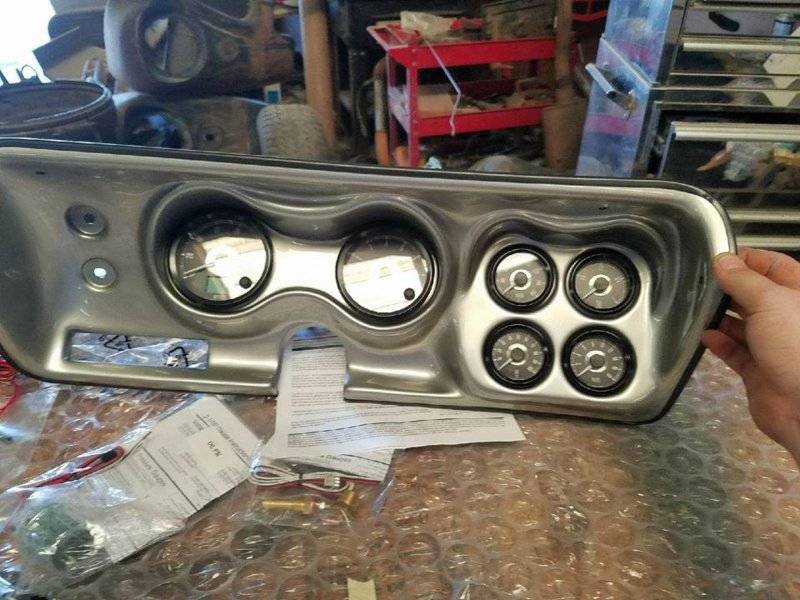

I opted for Speedhut and Classic Dash. Here are a couple pics - I am very pleased.
View attachment 579480 View attachment 579481 View attachment 579482
I have a Classic Dash for my 72 Plymouth. Only issue I had was the fitment for the OEM HVAC Controller. Had to spend quite a bit of time & effort modifying the back to accept the controller. The back of the panel was way too rounded to mount the flat rectangular controller, without lots of modification to make it fit. Curious how you handled the situation.
My classic dash worked pretty well and I didn’t have to modify anything to fit my hvac controls.
