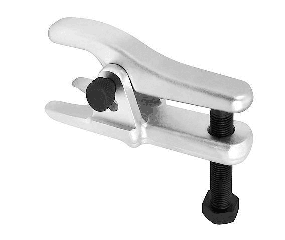

Now you need to separate the upper ball joint from the spindle. I don't like fighting with pickle forks - I've had great luck with the tool pictured below. This joint is pretty tight so it will not separate easy!!! I also like to take off the castle nut, turn it around and set it even with the end of the shaft so the tool has more to push on. It also keeps the upper control arm from violently separating from the spindle.
Now you can use the socket shown above and turn the ball joint out of the upper control arm. Installation is reverse of the above. (And I'm sure if I forgot something someone will pipe in and correct me too!)

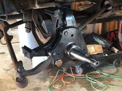

View attachment 1142075 View attachment 1142076
Thanks for the pic
The top intimidate me a bit the lowers appear to be held on by the three bolts. I’ve removed those when I installed the shorter spindle back on 08
