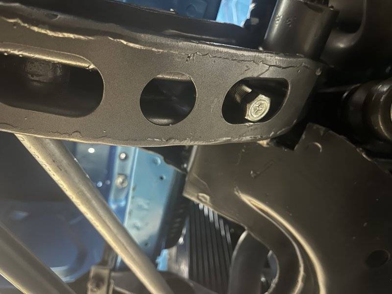

Went to adjust ride height on 68 Charger…, passenger side torsion bar bolt easily accessible, with a socket sliding over it into the lower A frame.
Drivers side- the bolt is too close to the slot in A frame, and can’t grab it with any tool. Do they make “longer” bolts, and where to get?

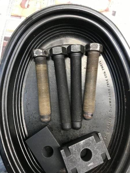

I’m only seeing complete kits which I don’t need

All new front parts by previous owner…. Its just that the drivers side bolt is too close to the slot side for a socket to go over it.
Maybe just cut the slot in the lower arm enough to fit a socket on tbe bolt?
Thought an easier route would be longer bolts if they’re available?
That bolt screws into a square plate that can be moved around a bit. If you jack the car up so the wheels are off the ground to take some of the pressure off that bolt you may be able to lever it over enough so you can get a socket on.

You need a deep socket.

Am aware of the deep socket, currently there’s no room for it ! Lol
I didn't see your photo when I commented. Those control arms have been boxed and you will need to enlarge the opening so the socket fits. You might be able to find a thin wall socket but they are not strong.
Sounds good!
Looks to me that whoever welded on the stiffening plates didn't pay enough attention to centering them. Not a big deal, just grind out enough to get a socket in there.
