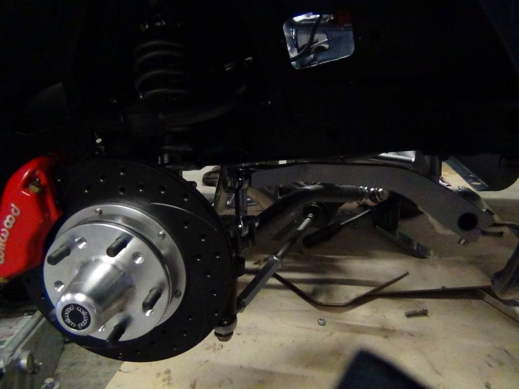

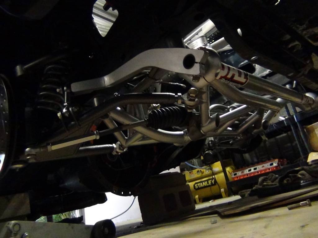

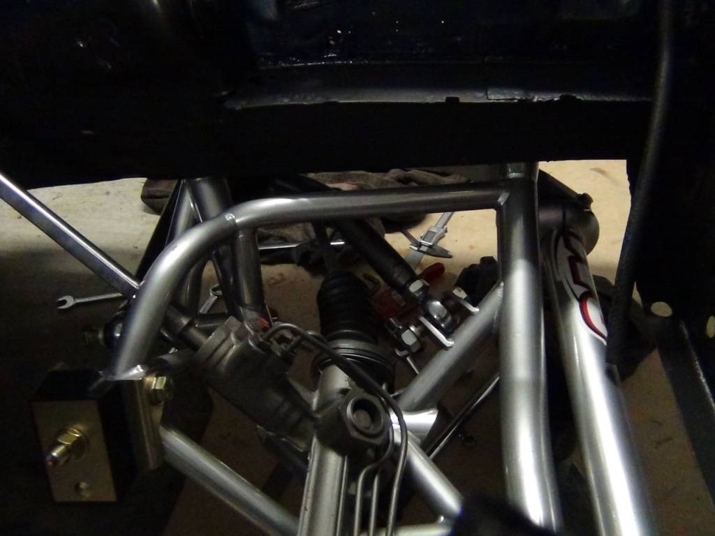

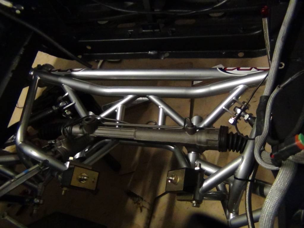

how about a pic of your front end.it will depend a bit on how it can be adjusted.my tubular upper arms can be adjusted at the bolts and at the spherical end links they have,so i can adjust either camber or caster or both at once.depending on what i adjust.
its a magnumforce front end heres a pic.
every joint has a heim end but has tobe undone to be adjusted
Camber, then caster sweep, then toe-in. Usually I start with the front cam all out and the rear cam all in on the UCA. I set mine at -.5 deg. camber, +4.5 deg. caster, and 1/16" toe in. This usually results in 0 camber at 1" of ride height elevation the toe should stay very close to at rest height specs.
