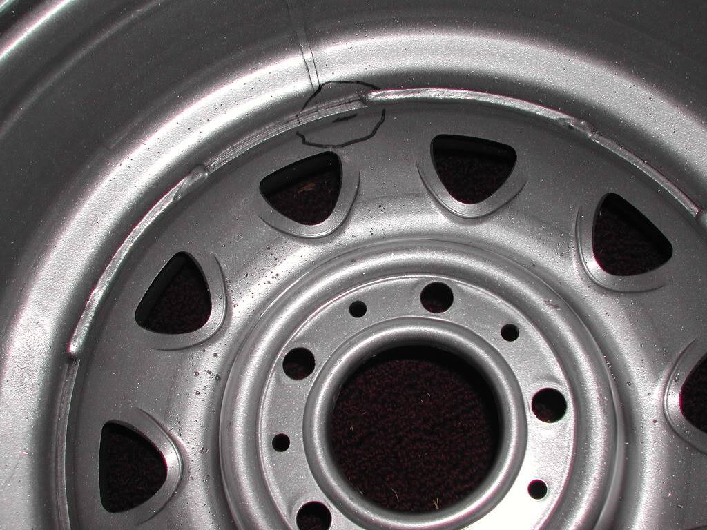

side lined by piece of crap brand new Wheelvintiques mopar rally wheels.

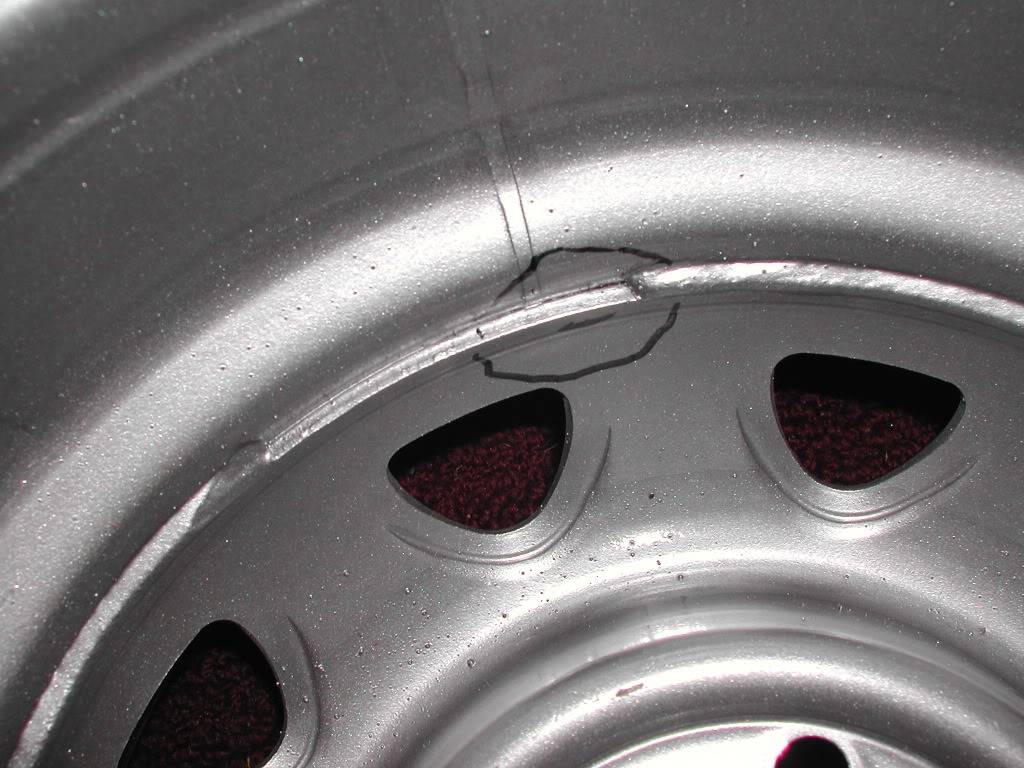

and one was flat. Nope, not an old one. A new Wheelvintiques. In the middle of the rim on the back a bad seam/weld was letting air blast out. Not to mention the "good" one had about 4 times as much weight on it as one of the basket case vintage ones. Looks like two lead hot dogs lines up on the edge of the rim.
They have a bunch of stickers on the rims when you get them about if you paint or mount them you own them. Don't see how they can weasle out of a defective product you don't know won't hold air until you
ve got a tire on there.

I marked where the leak was.
There is just no way to make crap like this right. You lose shipping, time, dropping stuff off, paint, etc.

That is clearly a manufacturing defect. Did you contact Vintique directly? I would think they would cover shipping to get you a new wheel and keep their good name. A sincere phone call, followed up with an email showing photos of the problem usually go a long ways. Good luck.

when you look around the forums, they have a TON of complaints about runoff, true, etc. I used to think that was just extra picky guys mad it took a quarter of an ounce to balance their wheel.
Then the wheels come with stickers "if you mount them you own them" "if you paint them you own them" and they brag about coming powder coated but then stickers that say "this is not a rust resistant coating you need to paint your wheel" so I am not that enamored of them right now.
Plenty of people get good wheels from them, but way more than should are getting bad rims. Quality control.
I printed out the form and sending them back to jegs. all I want is a good rim.

I would almost save the hastle and get it mig welded shut-i know you shouldnt have to but would save you time
can't say I was not tempted to bust out the grinder, and my 90$ flux welder.
