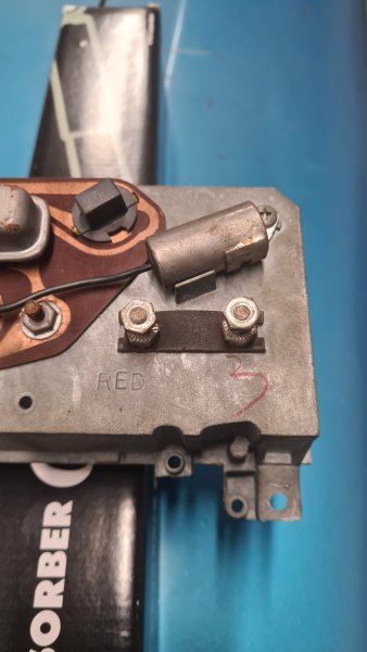

I remember seeing this discussion before and now I had to remove the dash... should I just plug the black/red together and bypass the gauge?

Real question is what caused the fire? Bulkhead connection ? I have never bypassed mine in any off my cars but bought a quick disconnect for my battery. Yes bolt and shrink wrap the two together if thats what you feel you need to do.
Bypassing your ammeter will not prevent a fire, unless it is shorted to ground. As stated above, the bulkhead connecter is a trouble spot.

You just have to restore/fix to factory conditions, and proceed with the propper upgrades.
You don’t bypass the gas line when pump fails.

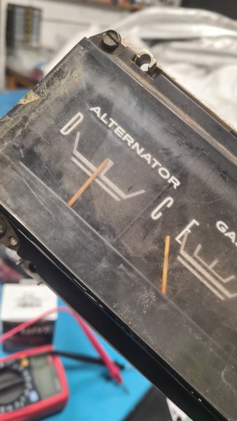

Technically it’s an ammeter, no shortage of posts/threads about ammeters here. The pictures of the ammeter and terminals in OP show no indications of previous heat damage. As mentioned focus on the weakest link in the original charging system, the Packard terminals in charge path in the bulkhead connector.
