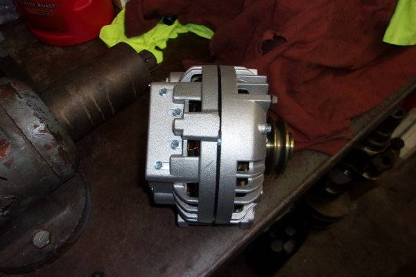

My son bought this one off the internet and I plan to put one on my 63. Its a one wire 100 amp alt and I like that it looks just like a stock Mopar alt. And it bolts up right in the same place as the stock alt with no mods. Ron
Is it Powermaster unit? Its a square back alternator (+1972 design) with the voltage regulator components inside the frame. Just be careful of the existing field wire connections to prevent them from accidentally contacting ground and to upsize the output wire to at least #8 AWG THHN or THWN to handle the additional ampacity.
BOB RENTON
BOB RENTON
Yes the regulator is internal as its a one wire alt. Just use the output wire and go. Rated at 95 amps actually and has been working great on my sons car so I plan to put one con my 63 soon. And yes its a Powermaster unit. Ron

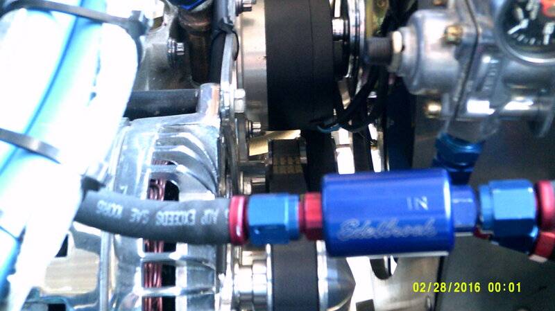

Just put power master on 1/2 hour ago with March pulley kit 165 amp alternator

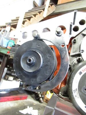

Update:
Still haven’t figured this out. I have a friend from the racetrack that runs an alternator / starter rebuild company. He suggested going with a Denso alternator. He said that the high amp Chrysler design units still don’t work with the low-RPM efficiency of new-technology OEM units. He gave me a Denso alternator to fit, and he’ll rebuild it after I have the bracketry dialed in.
Problem arose quickly, however, as the power pole extending from the back of the alternator interferes with the head. I’m going to get together with him to see if he has a similar alternator with the power pole in a different location. I still wonder if a power master or similar wouldn’t be a simpler option and work just fine (???).

Well, I ended up finding a Denso core that fit pretty well. It’s being rebuilt now, I’ll pick it up this week. Hopefully it will cure my problem. I’ll report back when it’s all done.
