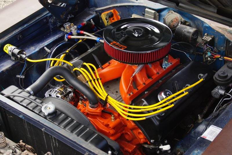

This is a Griffin 26" 2 row. Drop in, used factory shroud, looks close to stock and works great. My 472 hemi runs at 190 degrees even when it's 95 degrees outside.
That's actually an old Mopar Performance aluminum wp housing that came drilled and tapped.

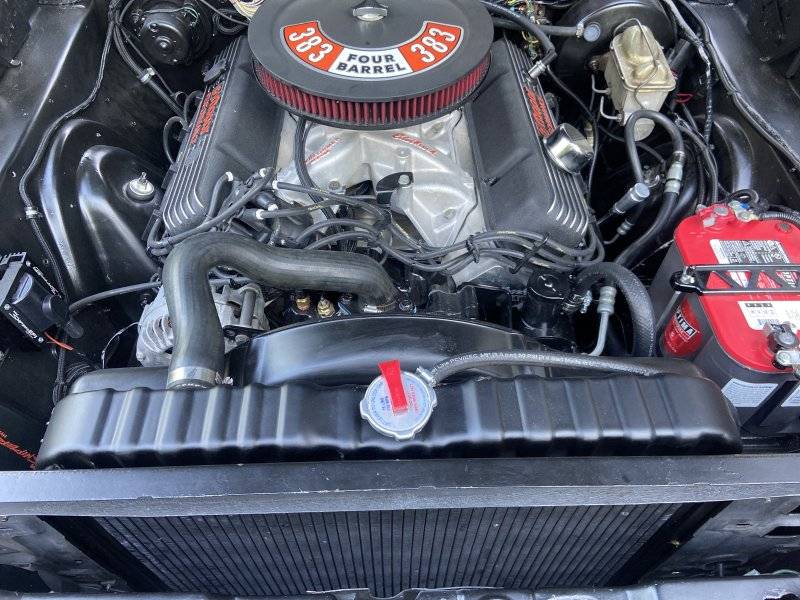

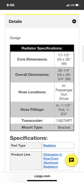

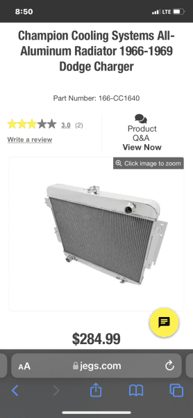

Hmmm. When I put that number in on Summits site, there were several complaints of the stock shroud not fitting do to the mounting studs being placed wrong. One of the people who had a bad result is a known heavy Mopar gent down in San Diego county who knows his way around cars.
I ended up getting this one and installing it. Did have to bend ears of drain plug a lil but was still able to use my shroud. Satin black matches my engine bay and it works great. Keeps my motor 165-170
I would suggest a 180 deg. thermostat 165-170 is a little low.
You can actually get more wear running too cold.
I have the same radiator in my Plymouth.
So far it works well.
On a drive it got to 175-180 I have another thermostat that’s 180. I’m having the sniper tuned in the morning so maybe I will switch after that.
