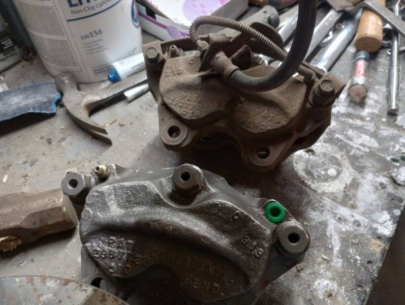

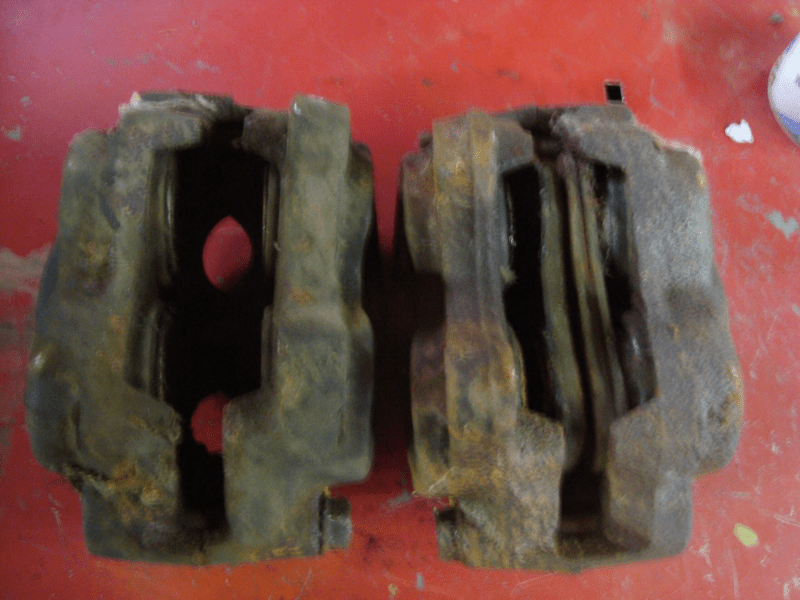

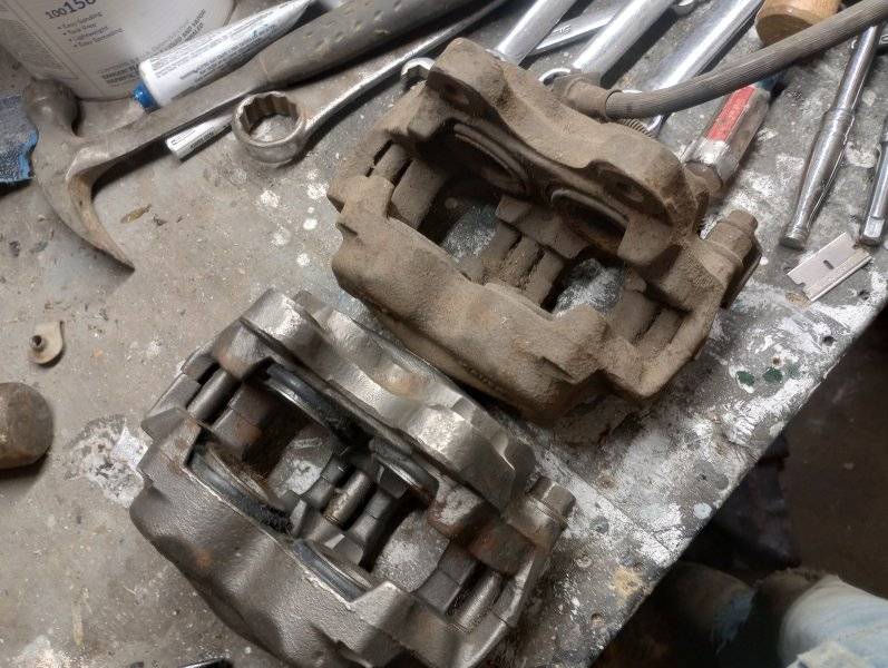

well...... here's what we have
but before I get there.........
the rusty caliper came on my 68 390 AMX...I am 99% sure
I am 90% sure my 4 piston calipers on my 69 AMX and 70 Machine were the same; but different than the one pictured from the 68.
all that being said...... the ones I have from the 68 AMX appear to be identical to the 68 GTX calipers

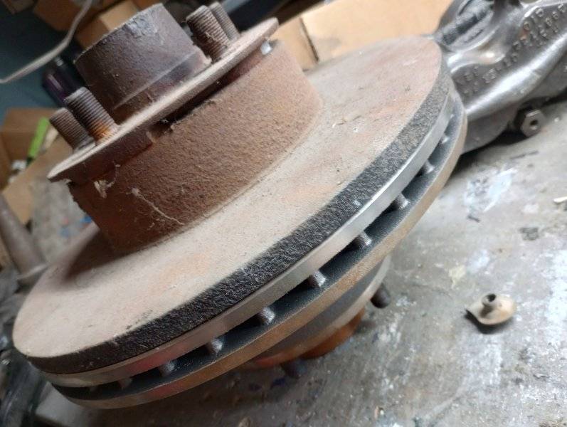

the AMC rotor is same diameter, but half the thickness, probably made up in the pads
I don't have bearing to mock up the rotor on the spindle....... and I hate not being 100% sure
So they are way different in terms of the width of the rotor, too many variables. I’m going to save myself the headache of an outdated caliper design. These are like the old vette calipers that always leaked. Time to update.
